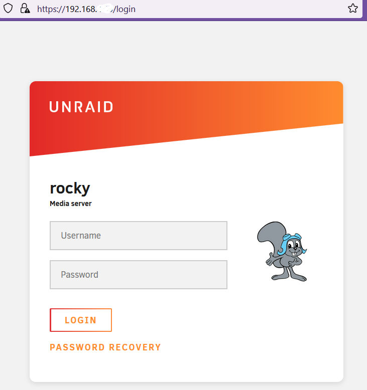

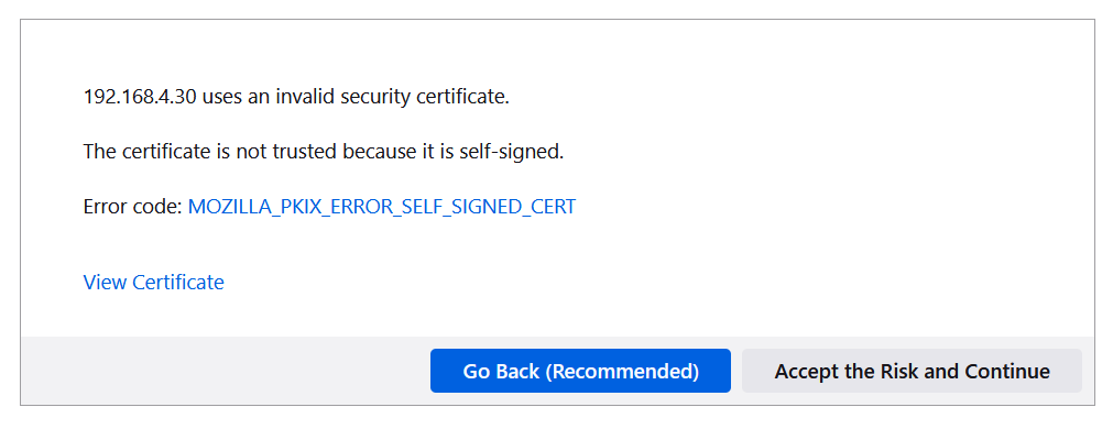

November 4, 20224 yr Scenario One Conditions - myServers plugin not installed - use SSL/TSL no - two SSL certs in /boot/config/ssl/certs root@rocky:/boot/config/ssl/certs# ls -la -rw------- 1 root root 2851 Sep 15 15:51 rocky_unraid_bundle.pem -rw------- 1 root root 2884 Sep 14 15:56 unraid-server_unraid_bundle.pem - Self-signed or user-provided certificate: /boot/config/ssl/certs/rocky_unraid_bundle.pem - Certificate URL: rocky.local - Certificate issuer: O = Self-signed, OU = unRAID, CN = rocky.local - Certificate expiration: Sun 12 Sep 2032 03:51:06 PM CDT - CA-signed certificate file: Not present local access results: http://192.168.X.XX/ works- signed in "not secure" http://rocky.local/ displays sign-in screen but refuses signin as root https://192.168.X.XX/ site can't be reached https://rocky.local/ site can't be reached Scenario Two: - use SSL/TSL yes - everything else set the same local access results : http://192.168.X.XX/ (redirects to https://192.168.X.XX/) does not redirect but does sign-in https://192.168.X.XX/ (uses certificate rocky_unraid_bundle.pem ) redirects to http and signs in http://rocky.local/ (redirects to https://rocky.local/) does not redirect but does sign-in https://rocky.local/ (uses certificate rocky_unraid_bundle.pem ) redirects to http and signs in I also have scenarios with the myservers plugin installed while using/not using remote-access that do not behave properly. But before delving into them, I'd like these two scenarios resolved. Let's keep thing simple. rocky-diagnostics-20221104-0835.zip Edited November 4, 20224 yr by Opus44
