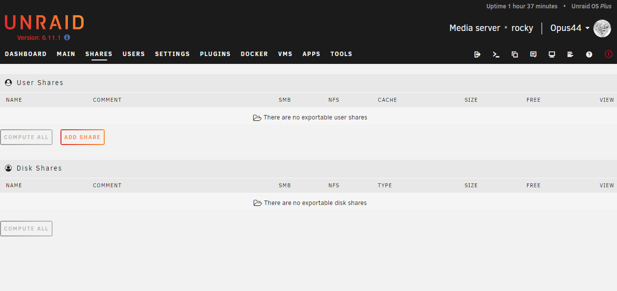

  9. Unfortunately I didn't take diags at the time the problem happened. My oversight. Sorry. If it happens again I shall be more diligent. Thanks for responding.

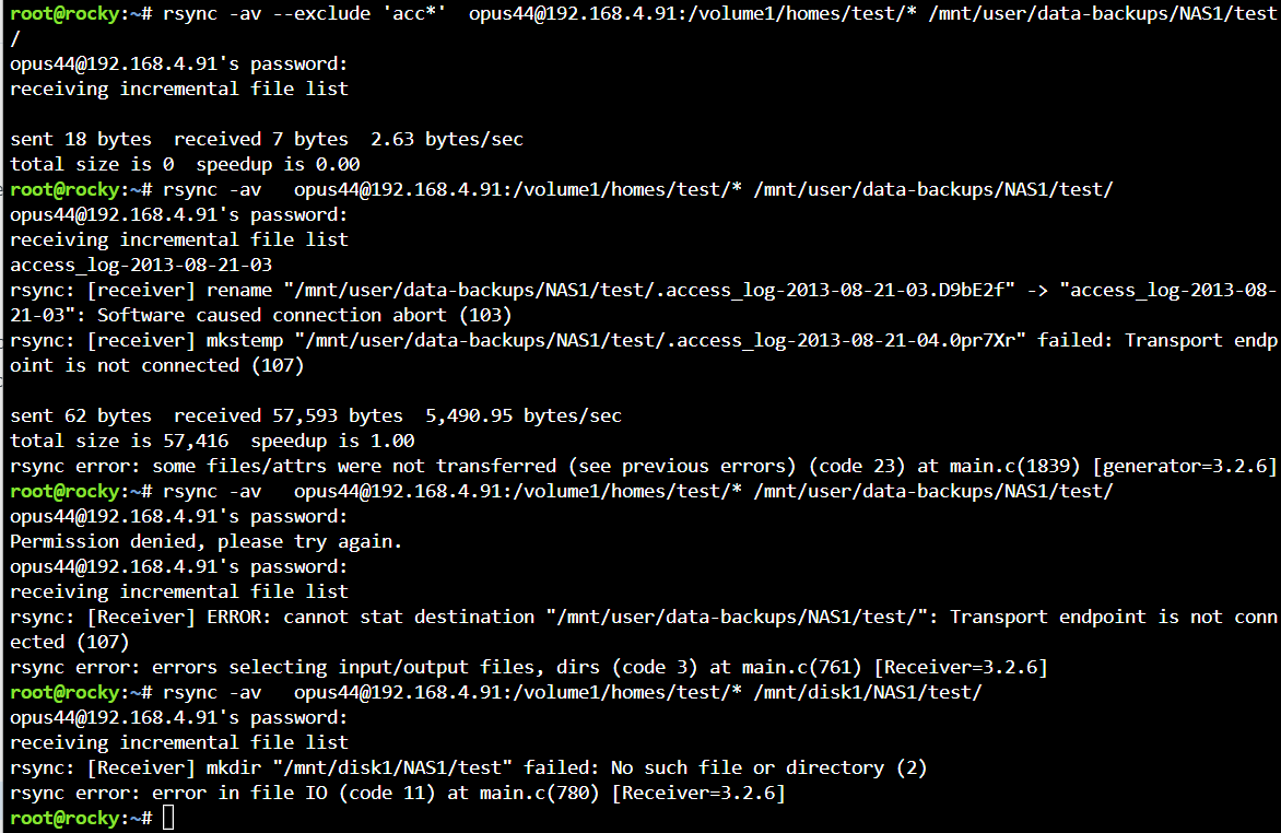

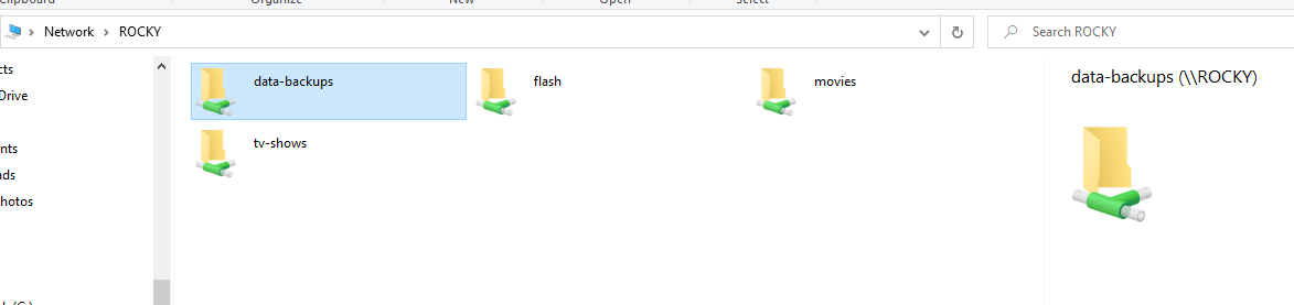

  10. rebooting brings the shares back, but it would be nice to have more confidence with rsync and user-scripts.
  11. I've a noobie to UNRAID and I've been setting up user-scripts to run rsync commands. While testing them, I ran into a problem that seems to have removed all my shares. Shares were defined days ago and I have been using them via windows, unraid user scripts, and the unraid terminal.
