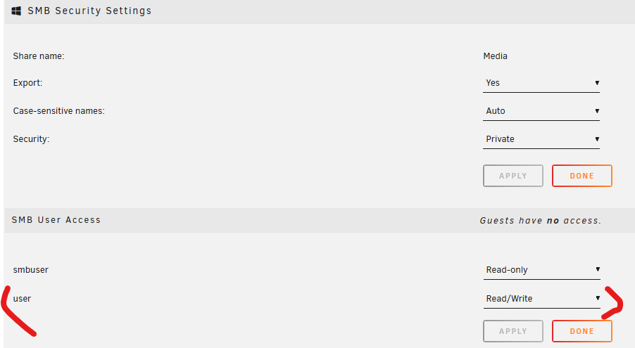

This one is difficult.  I have my Media files setup as Private.  I have two SMB users set up with Read-only access to these files.  One of the users is for all of the computers that require only read access to the files.   The other user is my personal SMB user.  This user generally only has read-only access to the Media share.  When I need read-write access, I log onto the server and change the Access rights as shown below:
When I am done with the changes, I change them back to Read-only.   (I do this to prevent ramsomware from having read-write access to the share!)
