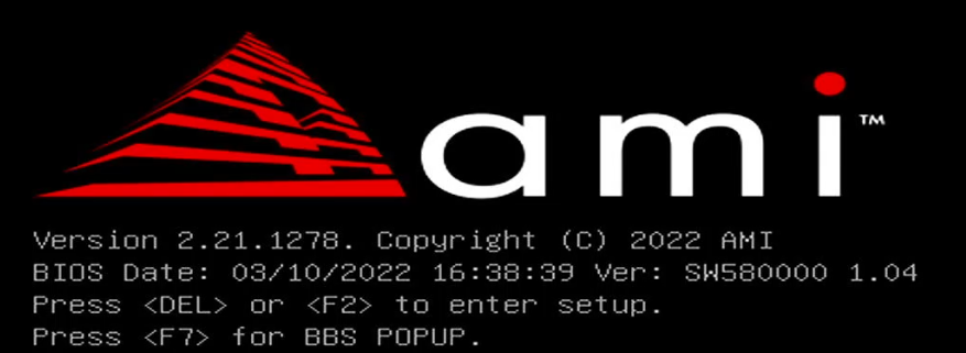

My Shuttle motherboard came shipped with the latest BIOS "03/10/2022 16:38:39 Ver: SW580000 1.04") and had no such problems listed.
But went ahead and downloaded the previous 1.01 BIOS , thats all, just wanted to share and save you the worrying, i already did that.

Here is a screenshot (boot, before entering setup) of what the Shuttle came supplied with originally.
I'll point Shuttle support to this thread.
Edited by barrystaes
