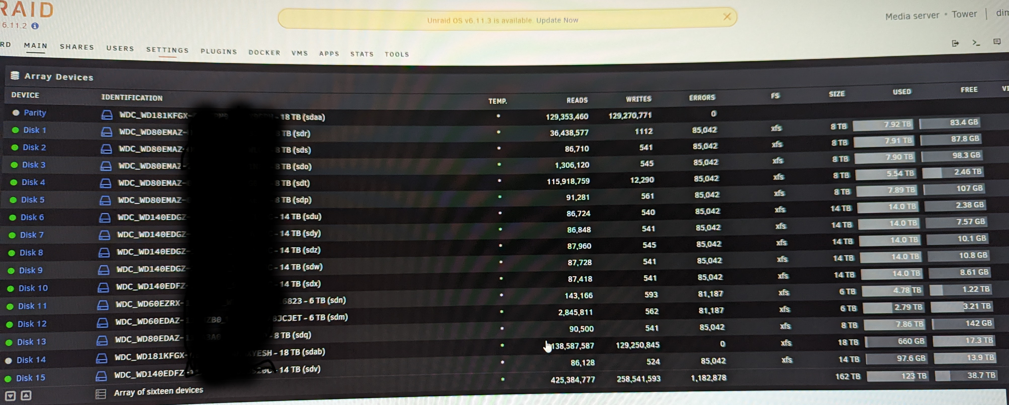

UnRAID 6.11.2 array Errors
Haven't really used the server for a few days. (Uptime 4d11h in the screenshot)
This morning tried to watch something on Plex and was greeted with errors that whatever I wanted to watch was not available.
Checked the UnRAID server to see crazy errors (all the drives with an error are on my NetApp DS4246 Disk Array)
During the last reboot, I added a new Parity drive and moved the old one to the array. Also updated to 6.11.2.
No hardware changes or any issues during the last 10m with the same hardware.
Updated to 6.11.3, rebooted. Seems ok for now.
Throwing this out here in case...

Simultaneous errors in so many disks is usually a power/connection or controller problem, not seeing anything in the log about the controller, so power down, check all connections and power back up, if it's an eternal enclosure check power/connection to it.
I understand. Thought it could have been related to the 6.11.2 issues....
NetApp DS4246 Disk Array has redundant power (using 2 of 4 power supplies) with both connected to different UPS's. So that part shouldn't have been an issue.
Will keep an eye on it though.
Thanks
Nope, issue was only when partition/formatting new disks.
