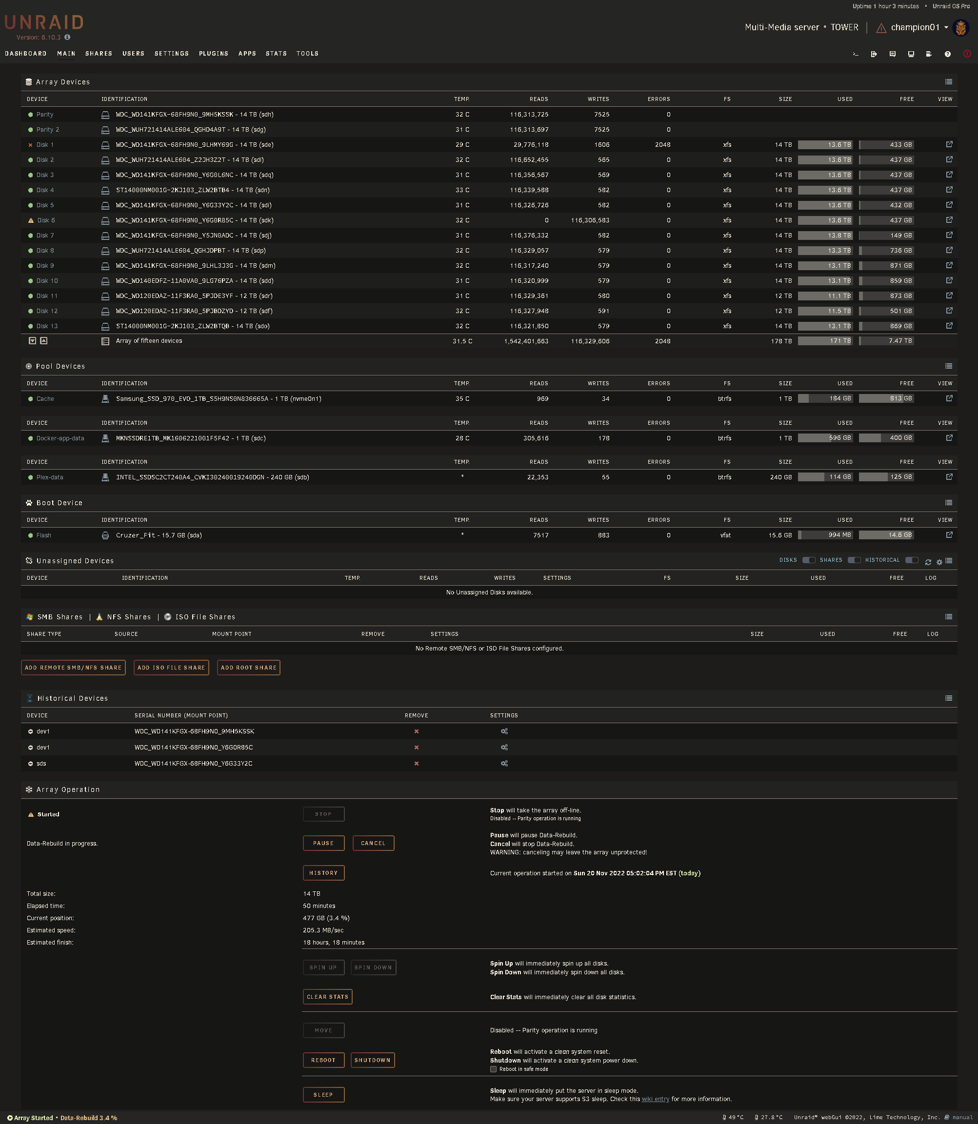

Hello all,
I have tried to diagnose this myself, but reading the diagnostics is a bit foreign to me.  I don't quite know what I am looking for other than the obvious. I looked at the syslog.txt and saw this line:
Nov 20 17:22:45 TOWER kernel: blk_update_request: I/O error, dev sde, sector 237609224 op 0x0:(READ) flags 0x4000 phys_seg 128 prio class 0
Not sure exactly what that means. I have ran SMART tests recently and have not seen any errors.
Perhaps its an issue with my LSI Card? I have (2) of these -->  (LSI SAS 2008 9211-8i - IT Mode)
You can see in my screenshot that I am currently rebuilding Disk 6, then had Disk 1 fail during the rebuild.

It's not logged as a disk problem, and that usually means power/connection issue.
