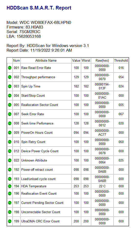

The old disk 15 is not in the server currently, but i ran an extended SMART test and it passed with no errors, as i planned to put it in a different server. Attached is the report that i did with HDDScan, if there is more detail i can run it if need be.

Yes, that disk looks OK, nothing written to the serve since you started the replacement?
