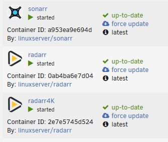

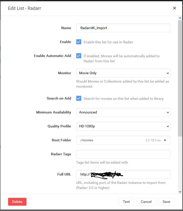

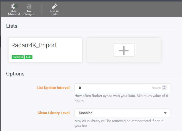

Sonarr I only use for 1080p TV shows.
For movies, I run 2 Radarr dockers - Radar and Radar4K.  I set a List in the Radar to mirror requests made in the Radar4K.
