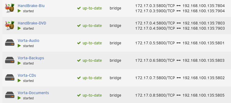

I don't use radarr or sonarr but I use multiple instances of a lot of apps.  If you know you plan to use multiple then change the name of the app when you install it and as Squid mentions, change the port.  What you change the port to is up to you but I just increment the number that the container starts with.  Some apps require some other tweaking but you'll figure it out as you go.  Just play around a bit.
Here's a screenshot of my backup server.  I have two Handbrakes so that my Blu-Ray discs use a different compression than the DVDs and I have multiple Vortas because Vorta only supports one archive (although Borg supports multiple).  In the end it's easier just to create multiple instances and configure them slightly different and turn them off or on as needed.
