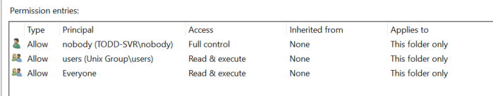

The trouble is, the "owner" for plex is a user called "nobody" which doesnt actually exist except from Plex, so I can't actually manually move or deleted files/folders that were created by the Plex DVR.  I have included snips of those folder permission as they appear to me for information.  There is no user called "nobody" in my unraid user settings.

These are permissions for a recently created folder by Plex.    When I try to modify the permissions from my windows machine it denies access.

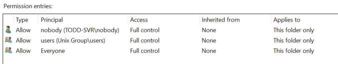

These are properties for a folder that has been on the server for a long time.  I have no idea how "nobody" was created as a user, but control is not limited.

 OK,  but the problem is that only "nobody" has access to modify those files/folders.  I don't have a userID of nobody to access with
Where it shows that only "nobody" has read/write access, I can't create or delete anything.
Where it shows that "Everyone has read/write access, I can delete, create folders etc..
How do I change the permissions
