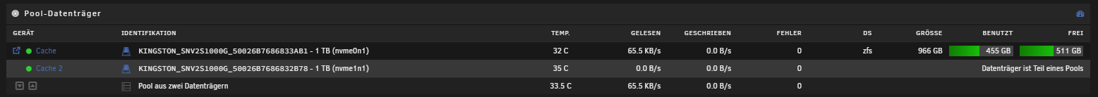

i have a issue with used space that is shown in the overview and the real used space with my zfs pool:
i am wondering why there is a size of 734gb of my 1tb m2 disk (cache) and 382gb of my 512gb ssds (cloud)
The GUI stats for zfs pool should always be correct, and looks like maybe you didn't post the complete df results, in case there are datasets, please post the diagnostics.

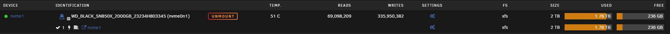

I've got a similar problem with the UI reporting a much wider difference than the console on one specific device. I must miss something.
The following is the device nvme1 (/dev/nvme0n1p1) mounted to /mnt/disks/nvme1
Those 2 representations are consistent. However when i check what is in /mnt/disks/nvme1 is where I see the much wider difference:
There is a delta of over 1.2TB. Any idea what this difference mean? Any additional information you would need to help me figure out what is going on?
Thanks!
Try checking filesystem, if it doesn't resolve, copy everything from that disk elsewhere, reformat and copy back.
I restarted the docker service and it sorted the drive itself out. The drive was pretty much only hosting docker containers config
