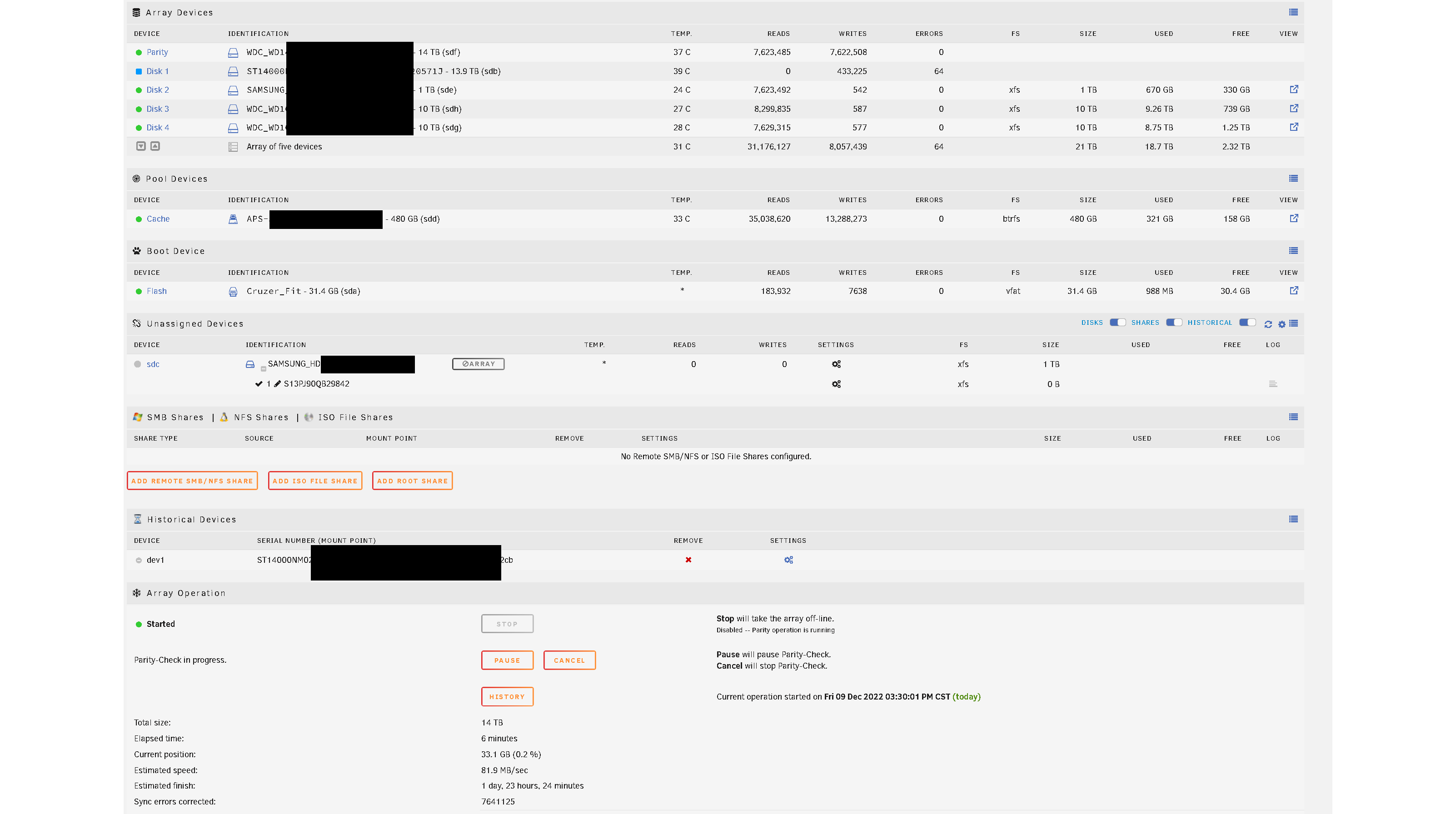

I was able to do this and after starting the array again a parity check began.  The parity check completed but the drive was blank under size.  I stopped the array again and then started it just now and it looks like it is running another parity check.
The icon next to the new 14tb disk is blue rather than green though.  I also see the same drive listed under historical devices.
Any idea what I'm doing wrong or what I need to do so that I can begin using this drive?
