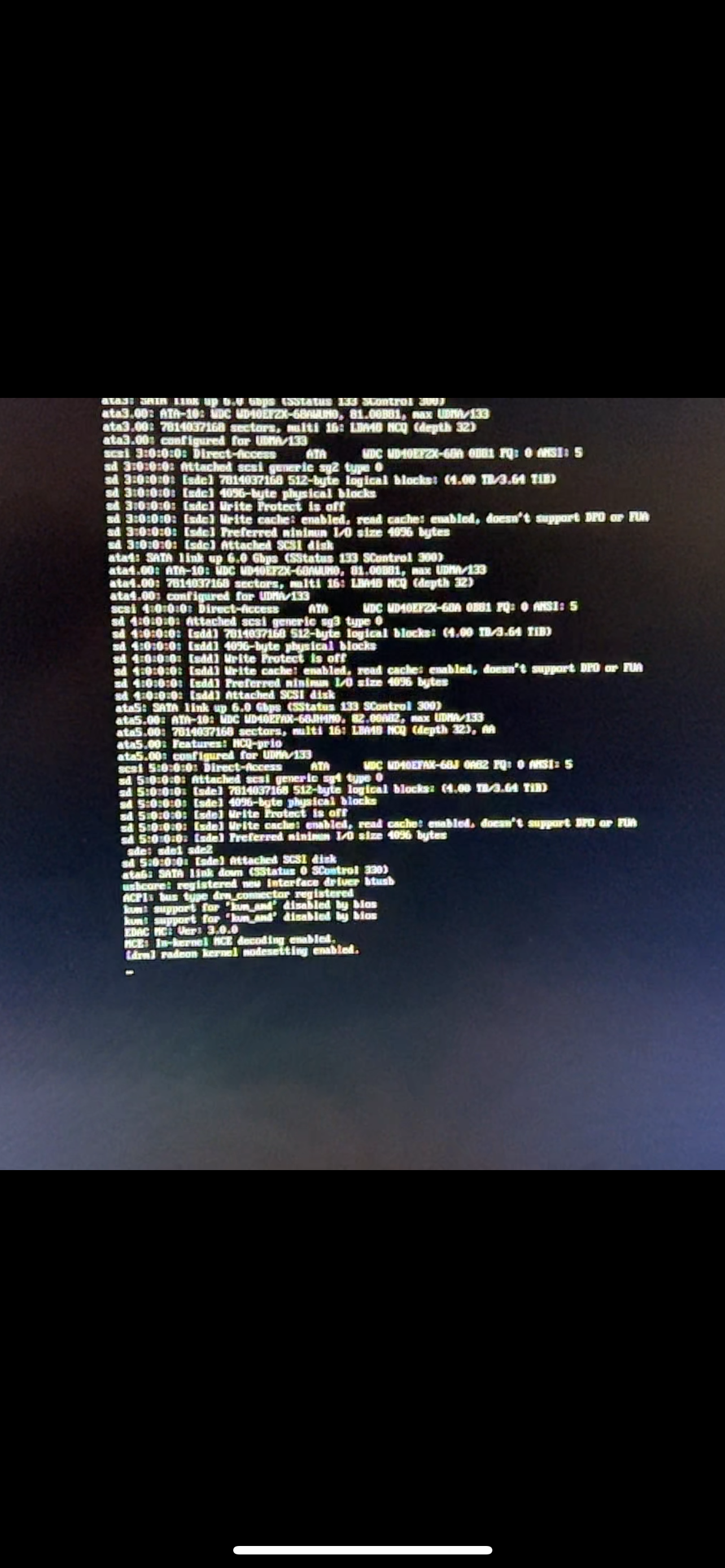

I’ve included a photo of the final steps of the init before everything goes dark.
I’ve since enabled Virtualization in the BIOS, same issue.
I have the strong faith that it DOES continue to boot and run. You just dont see anything.
