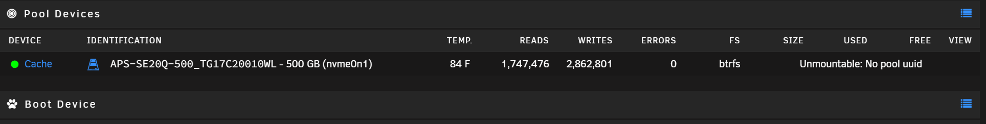

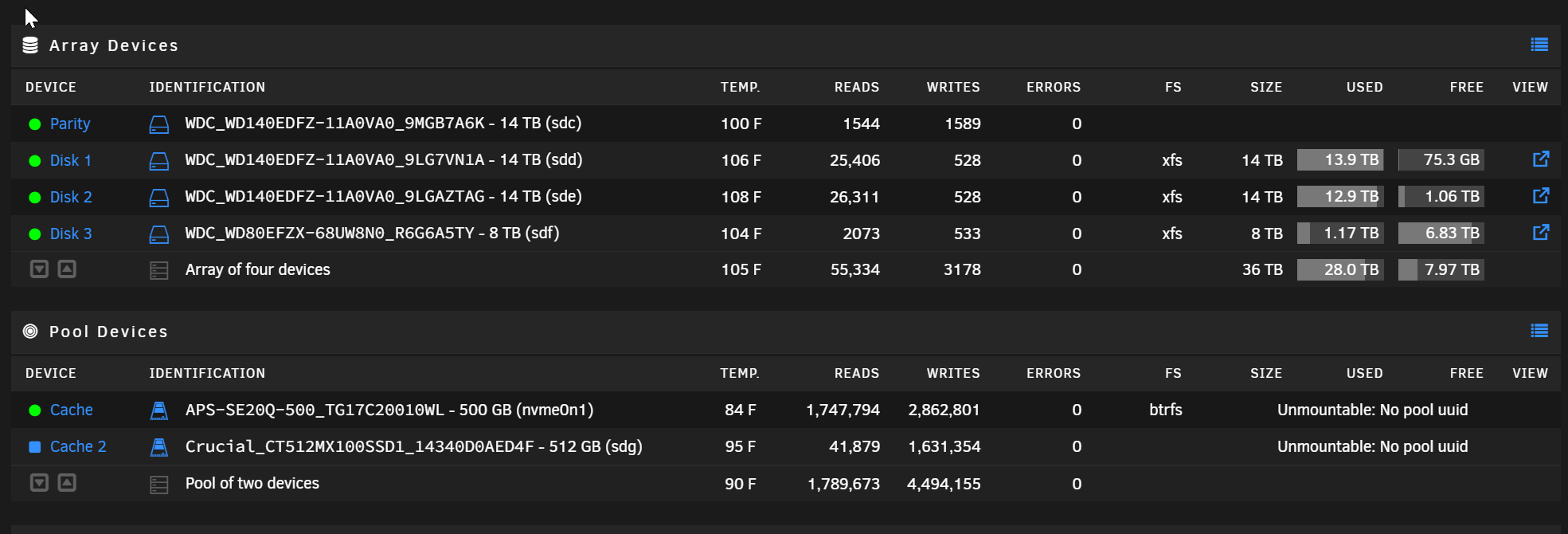

OK so I needed to upgrade my cash drive so I created a raid 1 pool by added a SSD to mirror my nvme, after complete i pulled them off line and tried to start the pool back up with just the SSD online, but that didn't work so i pull the array offline and added the nvme, but now i get a  Unmountable: No pool uuid.
Haven't written to anything to either drive so both should be good with data
How do i get one drive or the pool back up?

At one point you add the pool correctly mirrored, but the removed the SSD instead of removing the NVMe, then you removed thee NVMe without first adding the SSD back, hence the problem, post the output of:

Now stop array, unassign both cache devices, start array, stop array, re-assign both caches devices, start array, pool should mount, if yes run a balance to raid1, only after the balance finishes remove the drive you want, if it doesn't mount post new diags, but I'm about to go offline, so likely can only continue tomorrow if no one else helps before.

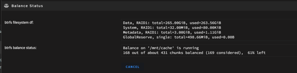

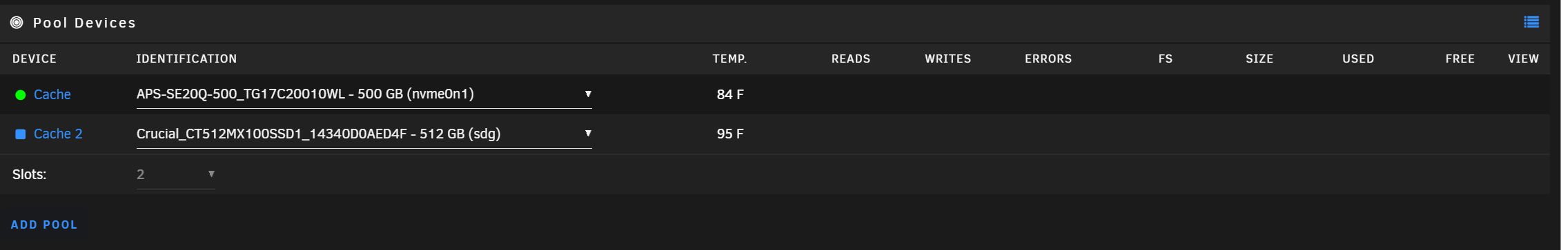

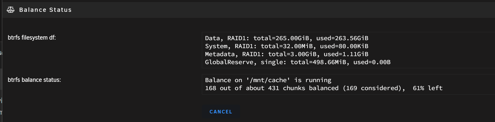

That did bring them both online and they are balancing
So when complete, I am going about this the right way, or is there a better way?
