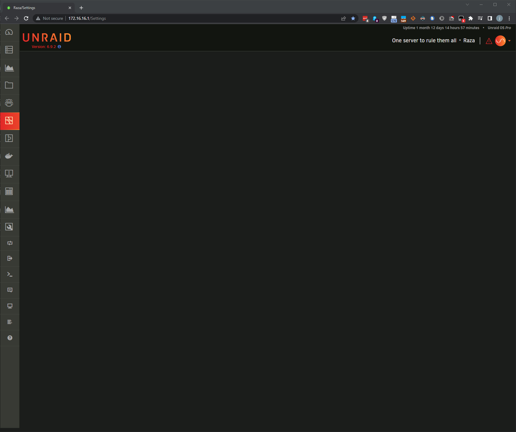

web ui loads frame but not content
i've had this issue for months now (think it started early 2022 but might have been at some point in 2021). When server boots everything is fine, and for a while after it is fine. But after a few days to a couple weeks it will start having this issue. The "frame" of the web ui loads, but the content does not. Sometimes stuff will load...a few times a day if i'm lucky. Behaves the same on dedicated 10g nic (172...) and local ip (192...), but used the 172 screenshot because dark reader messes with 192 differently. Also works the same on chrome, ff, ie, edge, browser in unraid gui, and i feel like i might have tried another browser too (plus mobile chrome and ff do same).
The error below screenshot is what it gives after the page sits with the frame but not content loaded for a few minutes.
Dec 17 08:40:30 Raza nginx: 2022/12/17 08:40:30 [error] 35647#35647: *7626036 upstream timed out (110: Connection timed out) while reading upstream, client: 172.16.16.2, server: , request: "GET /Dashboard HTTP/1.1", upstream: "fastcgi://unix:/var/run/php5-fpm.sock:", host: "172.16.16.1", referrer: "http://172.16.16.1/Dashboard"
SSH and vms (via other vnc access) and dockers and file serving all work fine, just the content of page fails to load. All the other answers i've seen have to do with nothing loading, unless i missed this issue being answered.

Rebooted and generated a copy of diagnostics from web ui. At some point between 1 and 2 days the issue happened again (does seem to have happened faster this time). Generated new copy of diagnostics via cli shortly before making this post.
After reboot i saw there were updates to some plugins and dockers, but for consistency did not update them yet. When back home after holiday trip i can reboot, update plugins and dockers, reboot, and wait for issue to happen again. Also having the ui back (for a short bit) can look back into what prevented me from updating the os and after resolving that will update os (unless you say not to until this issue is resolved).

updating to 6.11.5 seems to have fixed this, but not marking as solved till server is up for a month without it happening again
