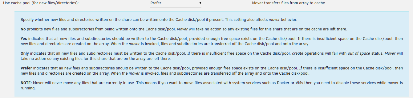

The storage location for the /mnt/user/appdata share can be set using the following setting found by clicking in the appdata share under the Shares tab:
The default location for the docker.img file is /mnt/cache/docker.img .  So it is already fixed to the cache drive.  (You change the location of either of these in the    Settings   >>>  Docker tab when the Docker is stopped.
