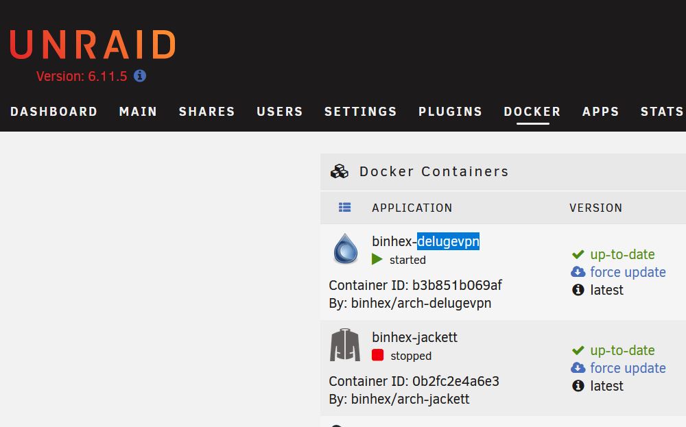

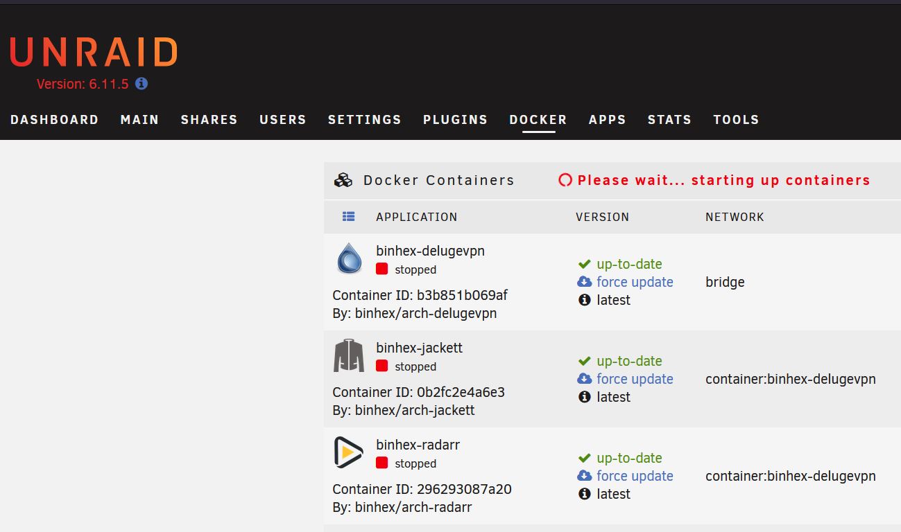

I tried to update my server from 6.10.3 to 6.11.5 this morning, and have found a strange issue. Update Assistant showed no concerns before the update, and I was able to access the machine again after a reboot. I experienced a separate issue when trying to start the array, where it showed 'array stopped - stale configuration'. Googling showed this to be a Firefox/webui issue, and I was able to start the array after restarting the server and using Edge to sign in.

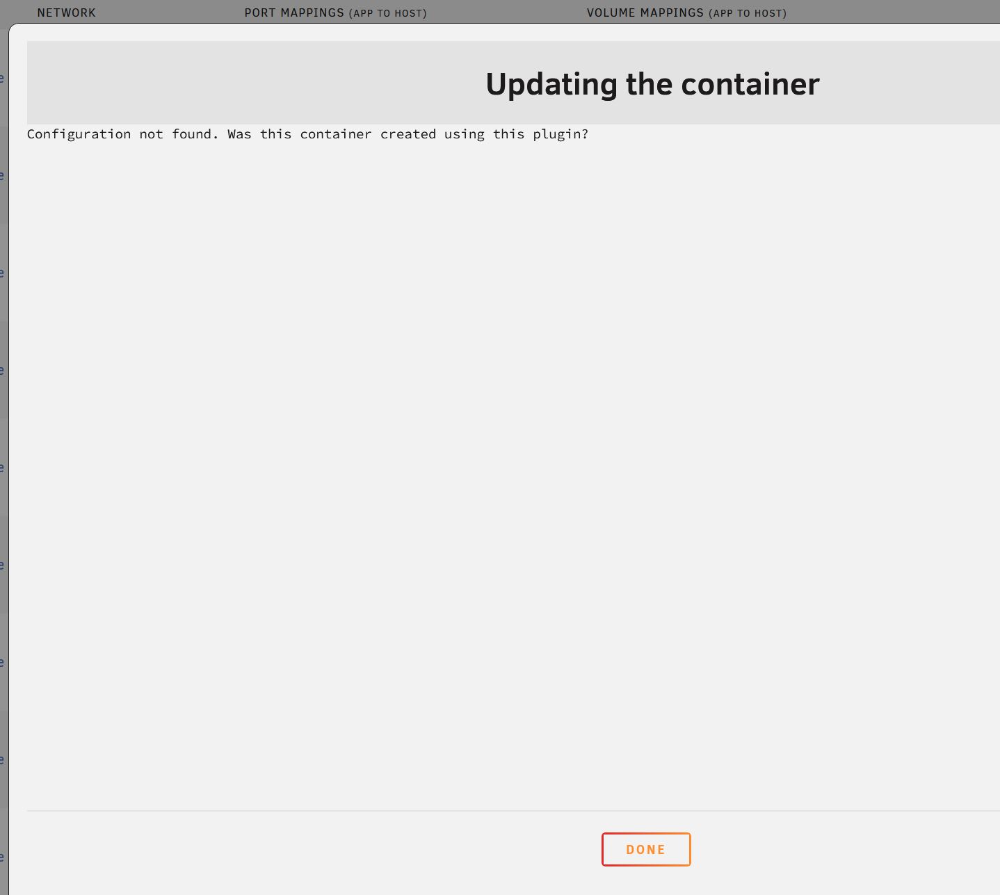

Now, the issue is that the update appears to have removed/corrupted the install of all my Docker images? The images still show on the page and are able to start, and appear to be working as expected - but I am not able to edit/update any of the Docker containers. So I am not able to modify the settings on any docker container that appears, and selecting 'Force Update' on the container gives a more ominous error:
"Configuration not found. Was this container created using this plugin?"

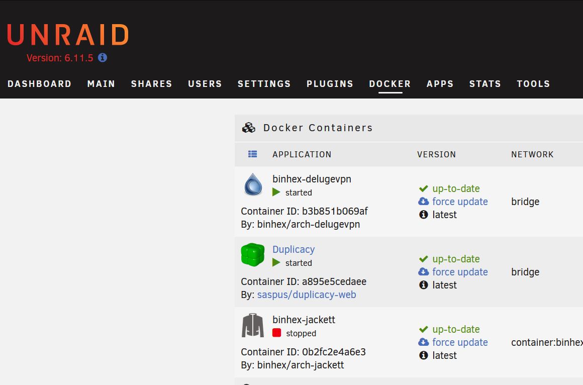

Cool. So I install a random new Docker image from the store, and that one works as expected - I can select the container name and modify settings. So somehow, it seems to no longer recognize the previously installed containers. I have restarted the server again, toggled the Docker service off/on, and can still view the folders in /appdata - but still the issue persists.
Any recommendations on how to correct this, or just drop back to 6.10? Images below for reference
https://imgur.com/a/DcyozwK

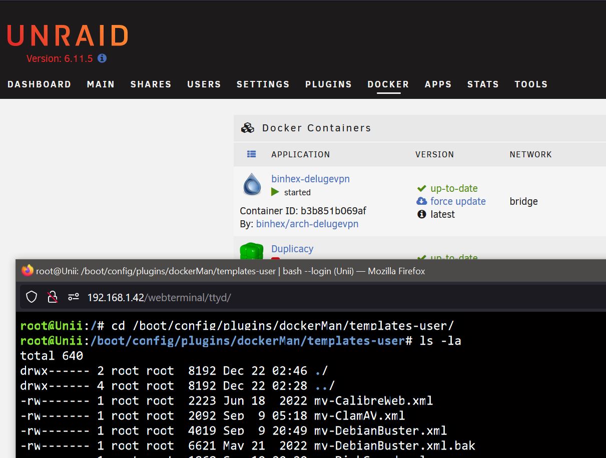

Because the folder /config/plugins/dockerMan/templates-user is corrupted and/or everything is deleted from it.  This is not anything (at all) related to the upgrade.
What is the contents of that folder?
Note : this folder is on the flash drive.

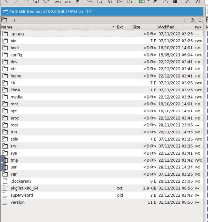

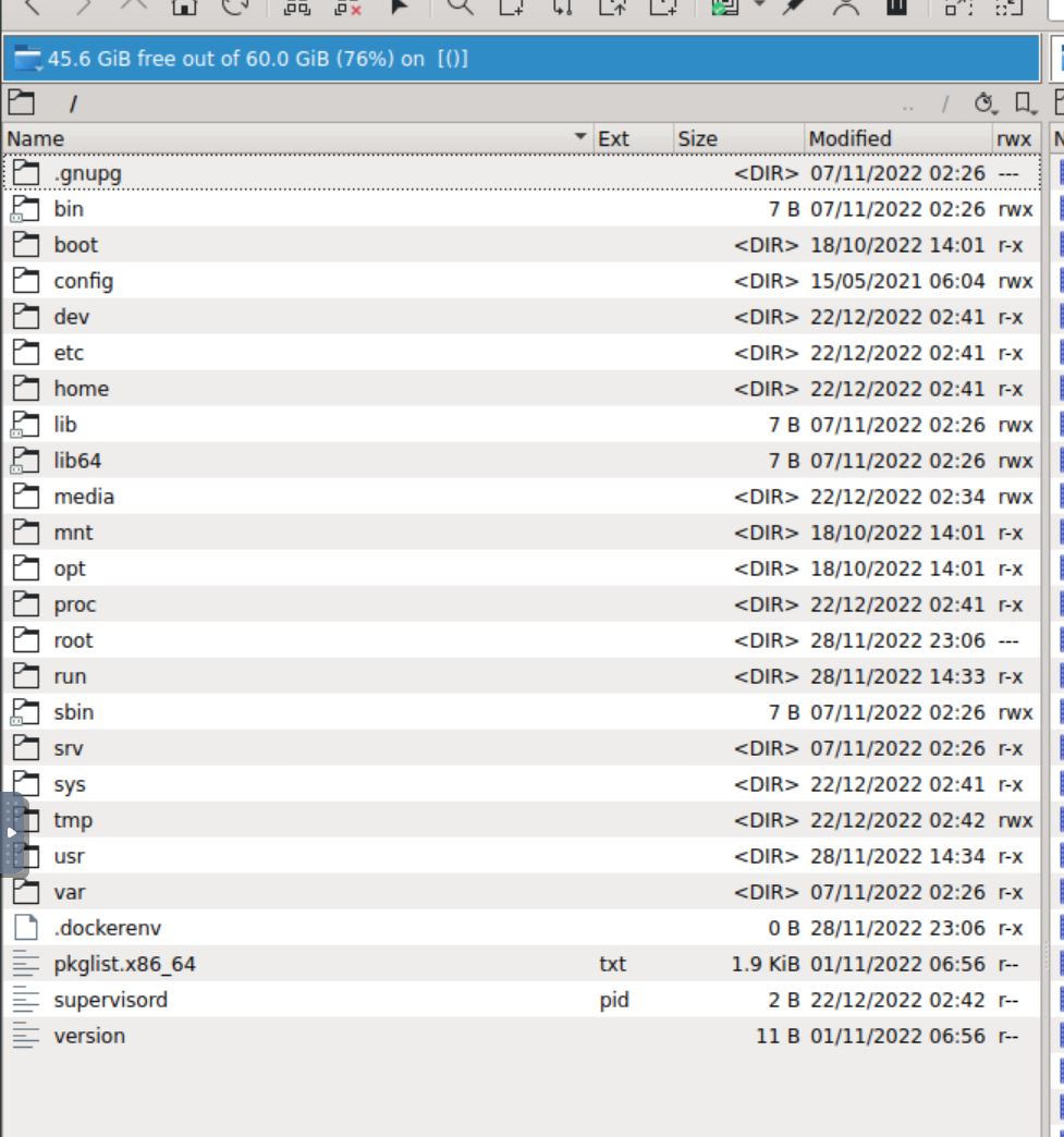

I really appreciate the quick responses! So I did take a backup of the flash before the upgrade, and there I can see plenty of files in the /dockerMan/templates-user/ folder. I'm having a harder time navigating to that folder on the running server - what would that file path be?
I typically use Krusader to interact with the unraid files - is the /config/plugins/dockerMan/templates-user on the USB drive accessible from here, or do I need to navigate there another way?
root@Unii:/boot/config/plugins/dockerMan/templates-user# ls -la
total 24
drwx------ 2 root root 8192 Dec 22 02:46 ./
drwx------ 4 root root 8192 Dec 22 02:28 ../
-rw------- 1 root root 3219 Dec 22 02:46 my-Duplicacy.xml
Found it - appears to be empty lol. So what would be the best way to restore at this point, copy the template files from the flash backup to here and reload the server?
