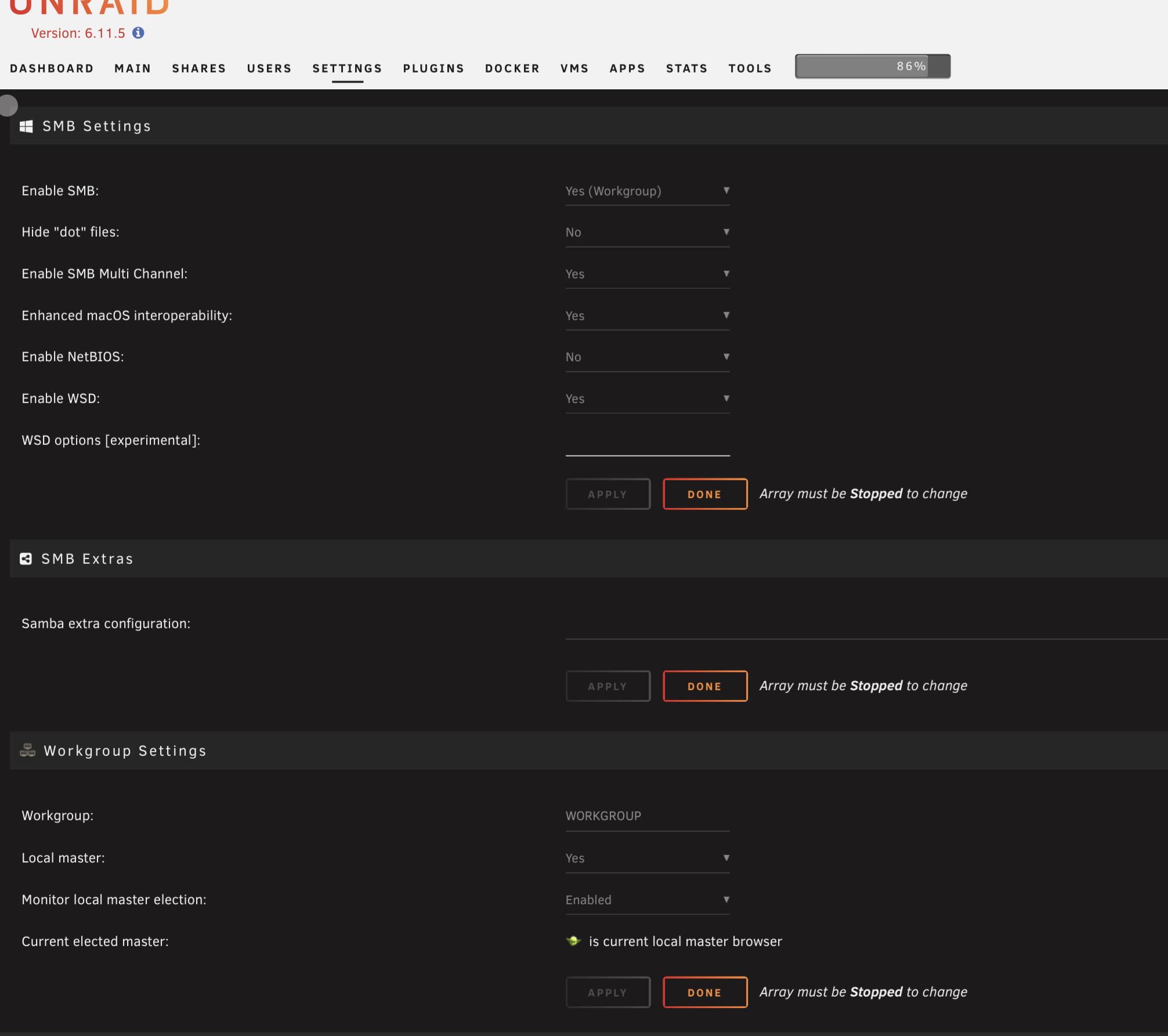

So something on my unRAID server is causing the incompatibility with Cryptomator, but I can't figure out what. My SMB extras configuration is empty. This is what my SMB config page is set to:
The only change I have regarding SMB is the recycle bin plugin.
I've tried transplanting the configuration options from unRAID to the Debian server to try and break compatibility there, but have so far been unsuccessful.
What is the difference between unRAID's Samba config and a vanilla Debian install's Samba config? Can anyone try out the Cryptomator app to see if they have a similar problem adding an existing share on an unRAID vault?

Figured out the problem: the "Enhanced macOS Interoperability" setting was causing the issue. Turning it off fixed it. What Samba configurations does this option add?
