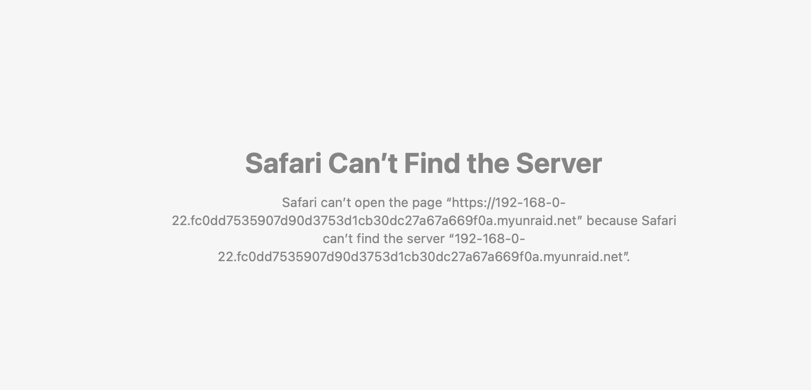

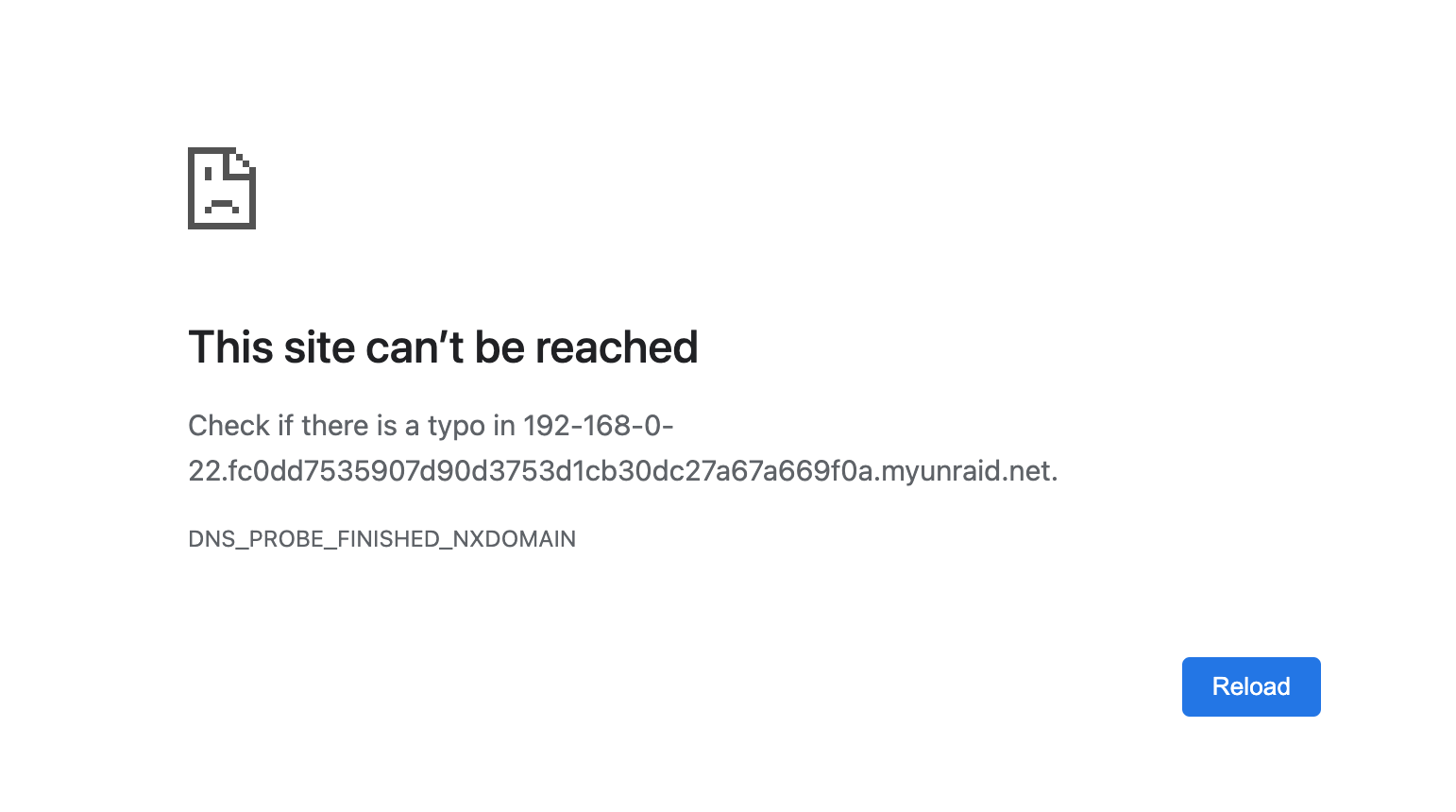

Same thing happened to me today. All the containers and everything are functioning fine, I can’t get the Unraid web UI to load.880675441_Screenshot2023-01-04at16_26_21.thumb.png.0310cea2cc64f60d0f11223ceabe9319.png

Same thing 462310551_Screenshot2023-01-04at17_33_38.thumb.png.046e801b7b2f8f097317d9f40019f38d.png
