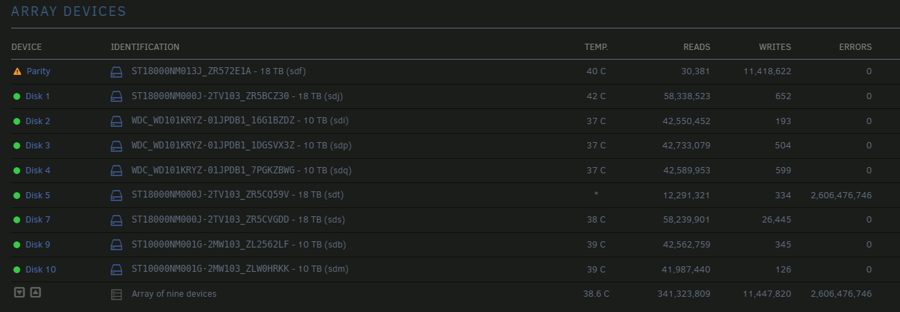

All of the array data disks in your screenshot mounted, disk7 has little if any data. Is that expected?
Also disks 6,8 have little if any data. Is that expected?

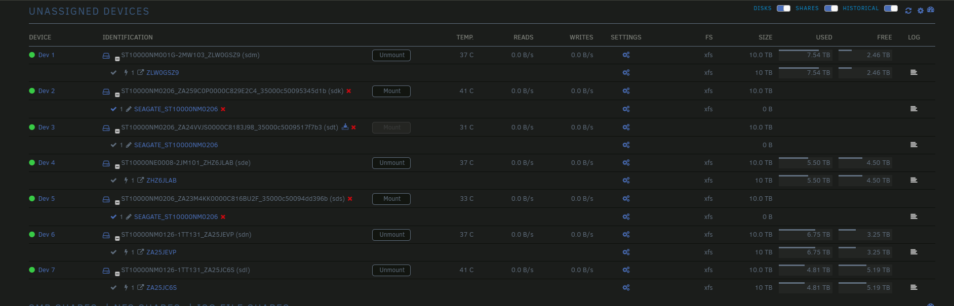

Will any of the unassigned mount with Unassigned Devices plugin?
the array as it is, is put together with what drive that are ok. Th below image is where most of my files are.

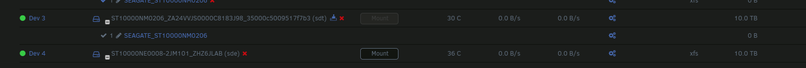

Dev 2,3,5,7 have errors. Dev 2,3,5 will not mount. Dev7 i still functional and im copying to the array right now what i have on this drive. The Fix permision tool worked and im able to write to the normal share folders from these unassigned drive.
At this point i think im mostly ok... with the exception of the 3 disks that either don't have a file system or will not mount. I have zero hope of getting the data off those drive unless you have any ideas.
It will take two or three weeks copying at ~60MB/s to the array from all of these unassigned drive.
16 minutes ago, donuts13 said:
will not mount
Are these supposed to be xfs disks?
You can check filesystem on Unassigned Devices. Be sure to capture the output so you can post it.
These are the 3 drive that started this mess...
Should I click the run with correct flags?   In the past the xfs repair has not worked but this seems different.
