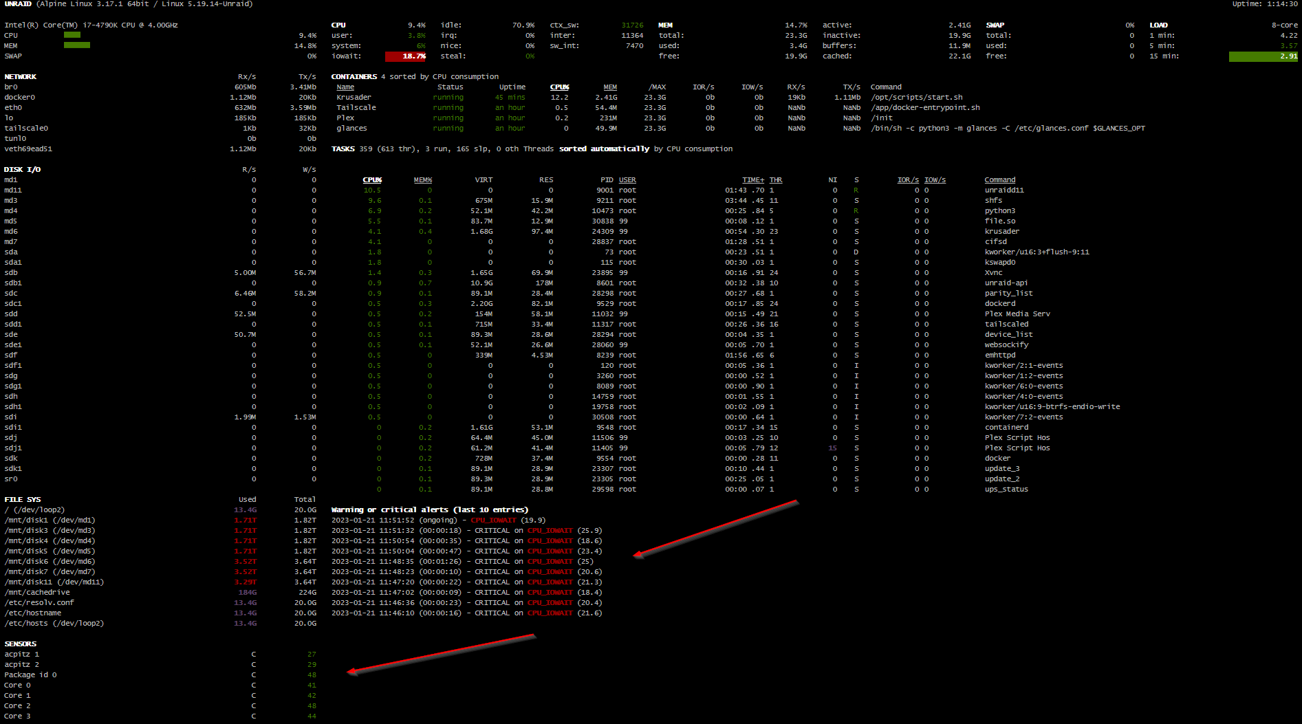

In glances, got this critical errors (check attached photo)
Thank you !!
Those are not critical, it's i/o wait, critical can be the MCE errors which usually mean a hardware problem.

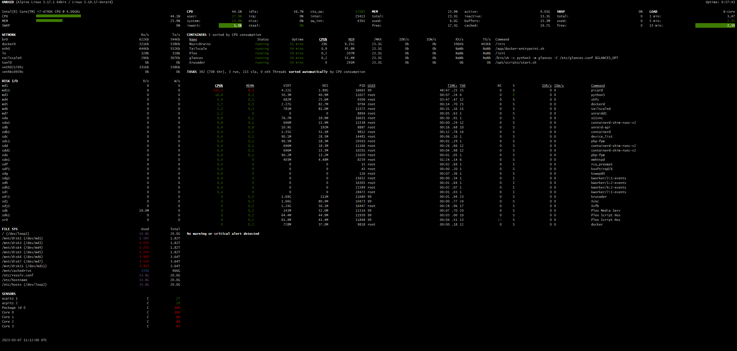

Here a screenshot from the Glances App. Right now i'm doing again the scanning with the MusicBrainz app and the CPU is under load
