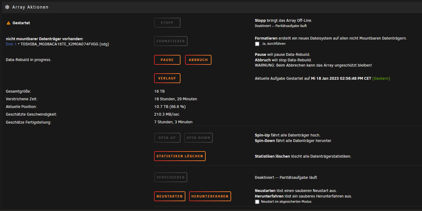

Hi

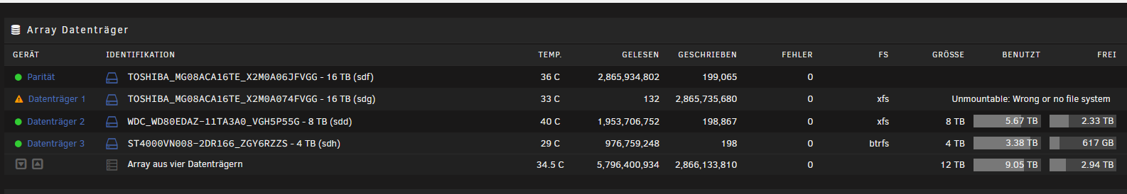

I'm currently running a data rebuild because I exchanged a 16 GB for a 12 GB. so I'm just a little unsure. The rebuild started normally but I get Unmountable: Wrong or no file system displayed. Does this change after the rebuild is complete or should I have formatted the hard drive again in the field below?
It won't change.
Formatting is never part of a rebuild, you should post the diagnostics but likely need to check filesystem on that disk, array must be stopped to do it, but since the rebuild is past half way probably best to let it finish.

Phase 1 - find and verify superblock...
bad primary superblock - bad magic number !!!
attempting to find secondary superblock...

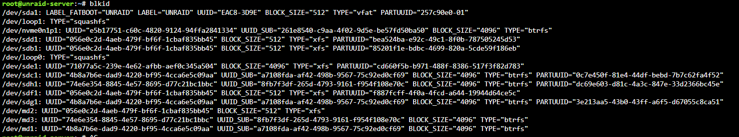

That's not a good sign, post the diagnostics and the output of:
blkid
Preclear test for this disk was good before I start the rebuild. It is a new disk.
Edited by platoboos

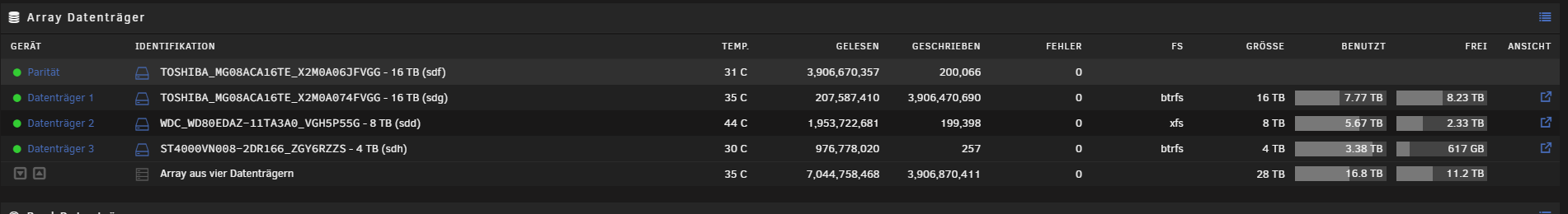

According to blkid disk1 is btrfs, stop array, click on disk1, change fs to btrfs, start array.
That looks fine🙂. Is it possible to change to XFS ?
