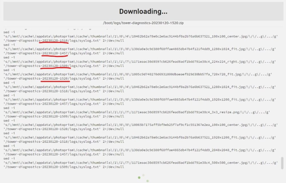

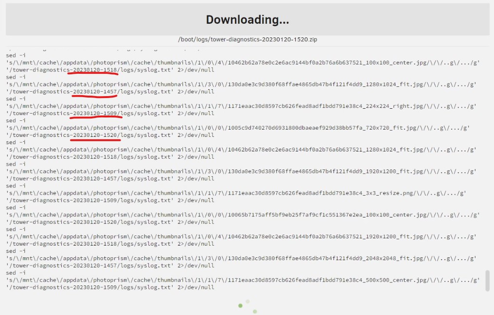

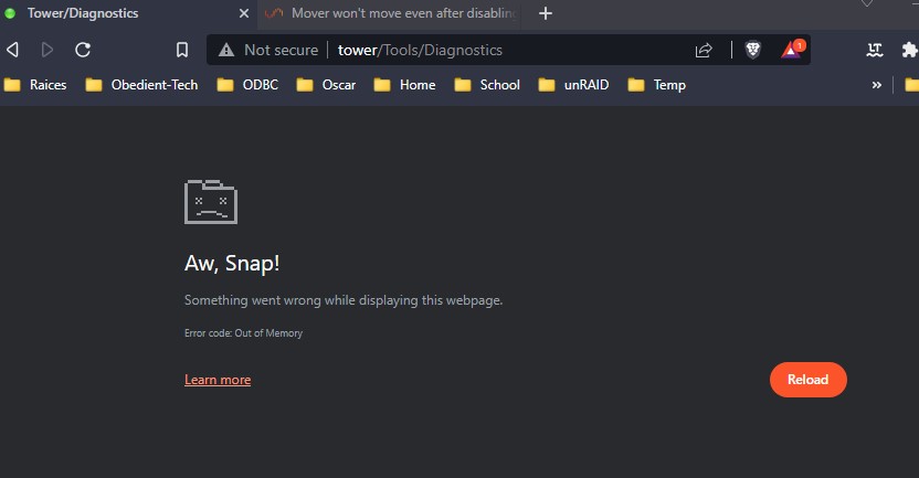

Is there another way to get the diagnostics  file? I restarted the system, I noticed the log was empty after the restart, I then check to make sure docker and VM's are still disable, and then I ran the mover. When I check the system again, the log was full again. I ran the diagnostics tool, but nothing downloads, I actually got an Ah Snap error.
I also noticed that it keeps 'downloading" data from PhotoPrism, but the same 4 files keep cycling.

Can you get syslog from Tools - Syslog?
It says:
Fatal error:  Allowed memory size of 134217728 bytes exhausted (tried to allocate 4096 bytes) in /usr/local/emhttp/plugins/dynamix/include/Syslog.php on line 18
The attached file is what downloaded.
tower-syslog-20230120-2222.zip
