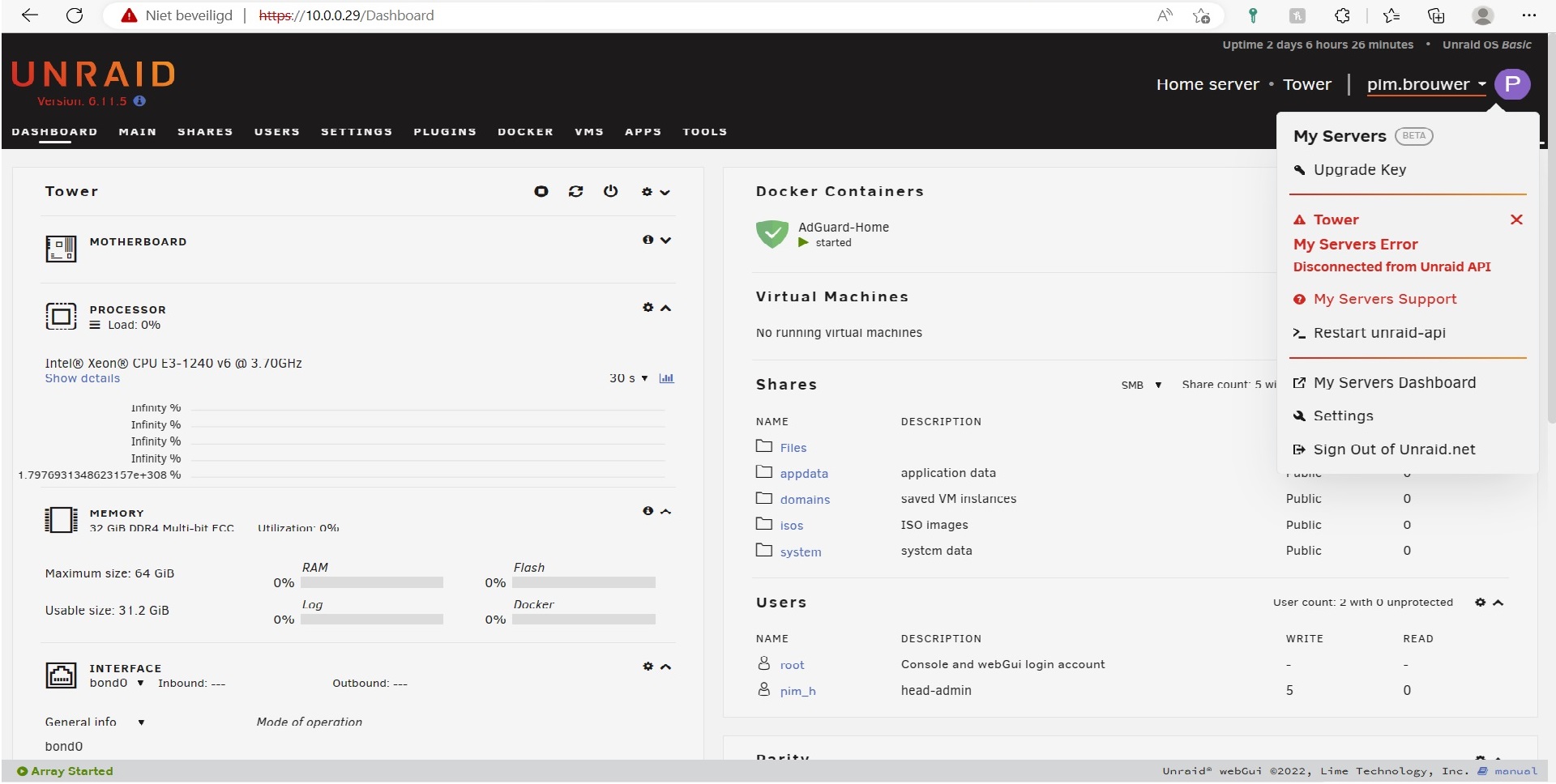

Earlier his week i had to soft power down the server by hardware button (single press let the system do the shutdwn) next day with booting up i got the error: Disconected from unraid api when i was veryfying boot and services start.
I have tried reloading the api via terminal on ssh (commands accepted and reporting back) no result.

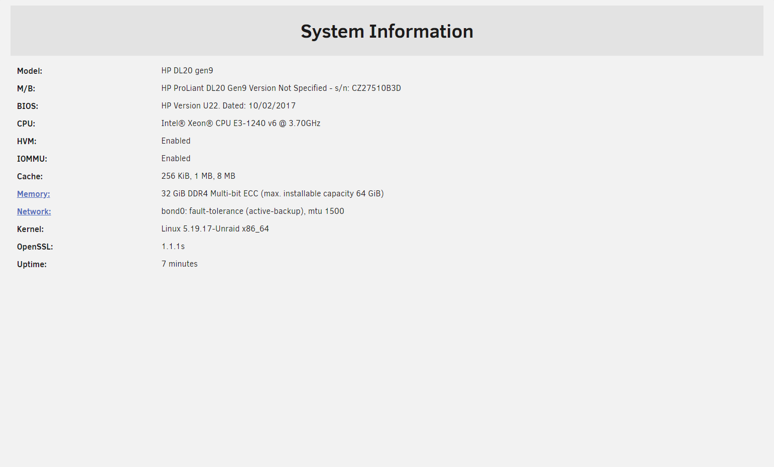

I cant verify the diagstics zip was made succesfully of annominous. I have made a zip with SSH. on request i will share with Lime personel via DM on request.
in zip folder are the screenshots with the gui, system nfo, apps curently installed.
GUI not operational as espected.7z
updated to new version with no effect tried restarting api true ssh also no effect

Everything looks good there, can you post a screenshot of the error?
Gui has not changed as in first post. in the post i added a zip with screenshots
I looked through the zip but didn't see anything obviously wrong. Do you have a screenshot that shows the problem?
It wont show my hard disks or there status and shows infinite load on cpy and no ram use. i dont call that normal or is this a other service. it used to work fine.

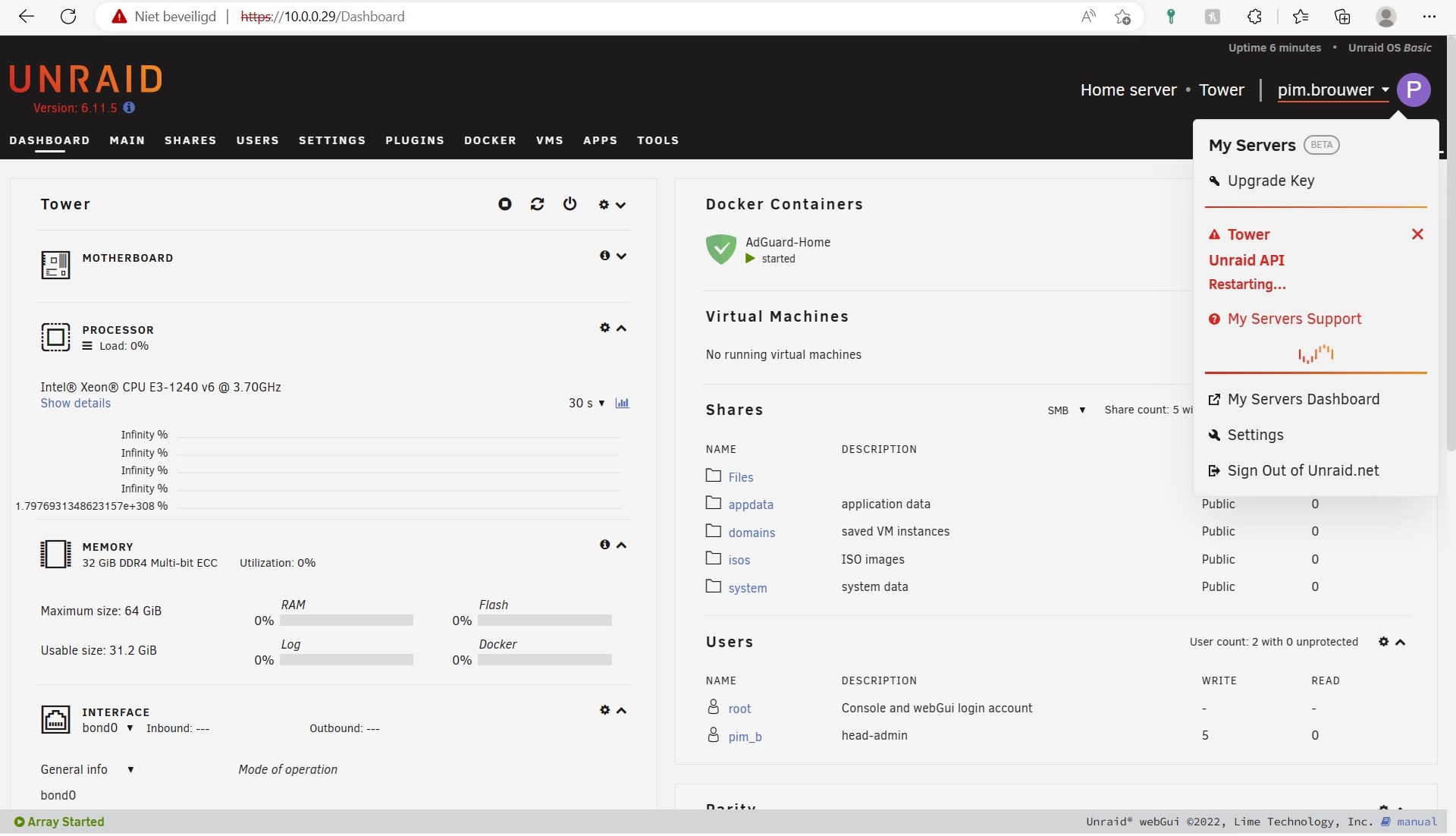

As shown the dashbord menu botton on my name will keep this on error. clicking on restart and the gui will show the wave thinkin patren but nothing changes. It will keep showingth e wave thinking untill i force refesh the page.

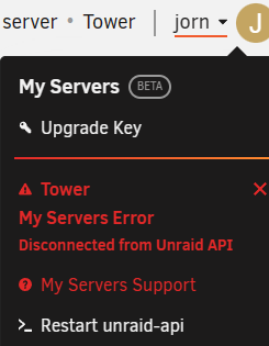

I got the same error after upgrading the certificate.
There is no connection to My Servers Cloud.
same here
On 2/5/2023 at 10:40 AM, CiscoCoreX said:
Personally I first tried restarting unraid api.
/etc/rc.d/rc.unraid-api restart
Didn't do the trick though. So I checked connectivity to te mothership server using wget. That seemed to work.
Then logged out of unraid My Serves account under Settings --> Management access, and then logged in again. That did the trick for me!
