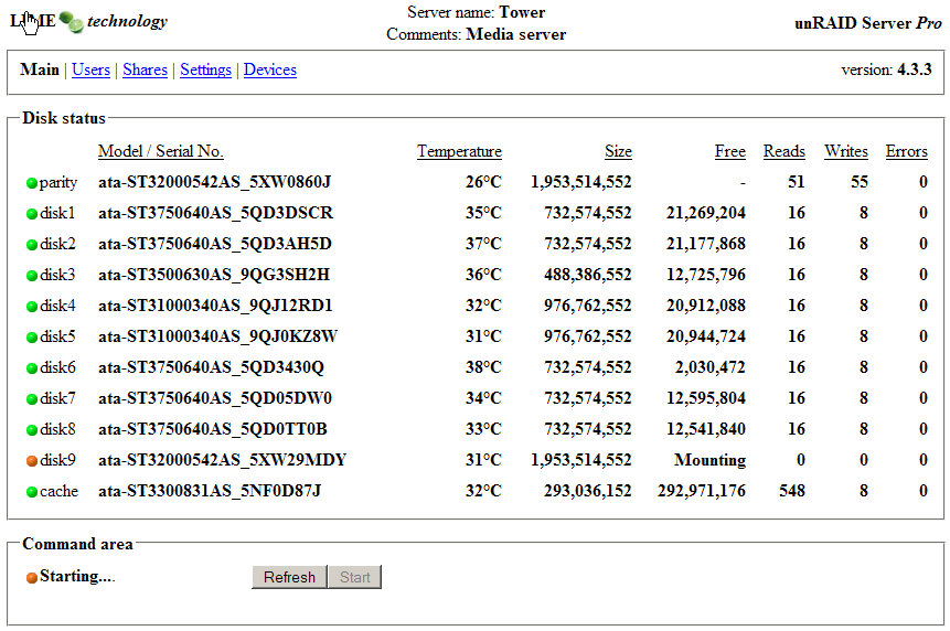

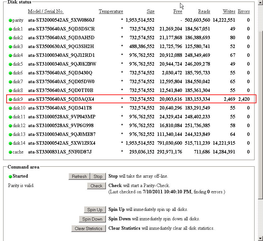

July 20, 201115 yr Hi All, I'm trying to replace a drive that was reporting read/write errors. I stopped the array, powered down the machine and swapped a 750 GB for a brand new 2TB drive. Started the machine, then went to web console and saw the new drive with the blue icon. Clicked "I want to do this"; and pressed the "Start and expand file system button". The system seems to not have found the drives after the new drive, and is stuck in a "Mounting state". The new drive was not pre-cleared, did not try and use it in another system, so perhaps the drive is bad? Any suggestions on how to proceed? My first inclination is to power the system down via a telnet window, remove the drive and see if the new 2TB mounts in another system. Syslog, and screensnaps of before/after are attached. Any suggestions? Thanks in advance syslog.zip
July 20, 201115 yr Author It does not seem to be a browser refresh problem. None of the drives that should be displayed are displayed. The syslog is complaining about failing to mount disk9: Jul 20 19:55:04 Tower emhttp: disk9 mount error: -117 I've removed the drive and will try and see if the drive works in another PC.
