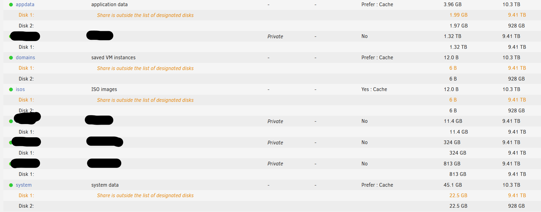

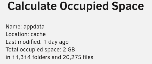

Thanks for the help, I was able to install the backup plugins an disable docker and VM Manager to run mover. I ran mover via 'settings > Scheduler > Mover settings > Move now' and It copied the folders, I think, because they're both on the cache drive and on the array so I think that's what you mean by the manual cleanup. It does look like all the files where copied so would it be safe to just delete those from the array at /mnt/disk1/ using 'Dynamix File Manager'?

You should examine the files on disk1 to make sure you don't need them. system share looks like it might be duplicates, less clear about appdata
