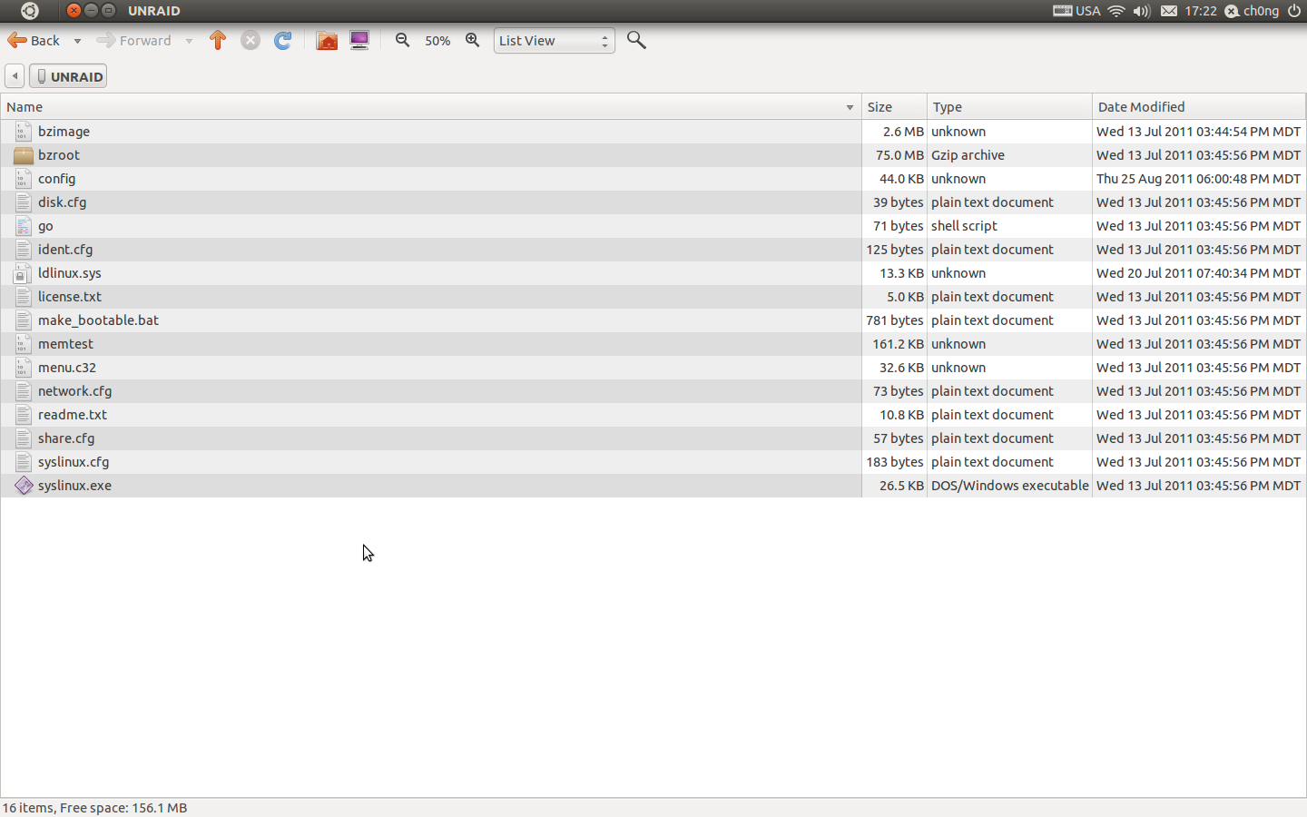

I am running unRAID Basic version 5.0-beta9. The drive isn't write protected, after shutting down the server I copied a small text file to the drive (then deleted it) without issue. The stick definitely isn't full, it's a 256MB drive and unRAID is only taking up 78MB.
I have never altered the permissions of the drive in any way. The only thing sticking out to me is that there are no folders on the drive. Here's a screenshot of it (click it for the full size picture):
Ah, that makes it clear!
You have de-archived the AiO.zip file into a flat, single level directory, rather than preserving the directory structure.  Check the options on your archiver software, and try again!
