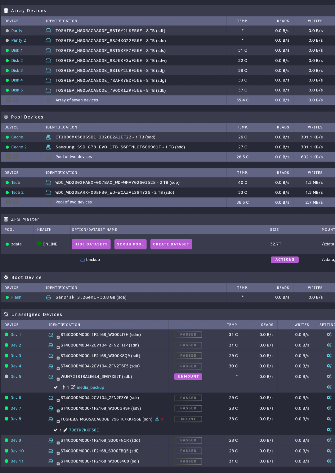

I have been trying to troubleshoot why my array disks won't spindown. Reaching a dead end and would appreciate some tips on how to investigate further
Here is my setup
My setup is to have minimal array read / writes. Most stuff goes to the 2 pools. Even within array, disk 4 should get occasional writes while others are expected to be idle through the day. Unassigned Dev 5 is a backup drive, used once a night. Dev 8 is a precleared spare not in use.
Spindown is set to 1 hour in disk settings.
I only see parity and Dev 5 stay in spindown. I expect most array drives to mostly spindown, and I don't see a reason why dev 8 should spin up at all
At this point I am suspecting the LSI 9300-16i, since the drives that do spin down are connected directly to the motherboard SATA. But I don't understand why this should be a problem in pure HBA mode
I have tried to use file activity plugin on array drives which confirms no array activity for a few hours and drives are still spun up. I am stuck at this point, since it confirms what I expect, but I don't know where to look next. Some ideas will help

I did not have an opportunity to take the array offline yet, but I issued a global spin down to see what happens.
As expected, all disks spun down, so at least spindown works. But slowly, one by one, all of them came back up within a few minutes, including the pre cleared unassigned drive that is completely unused. So seems spindown itself works, but something wakes up all the drives on the HBA
