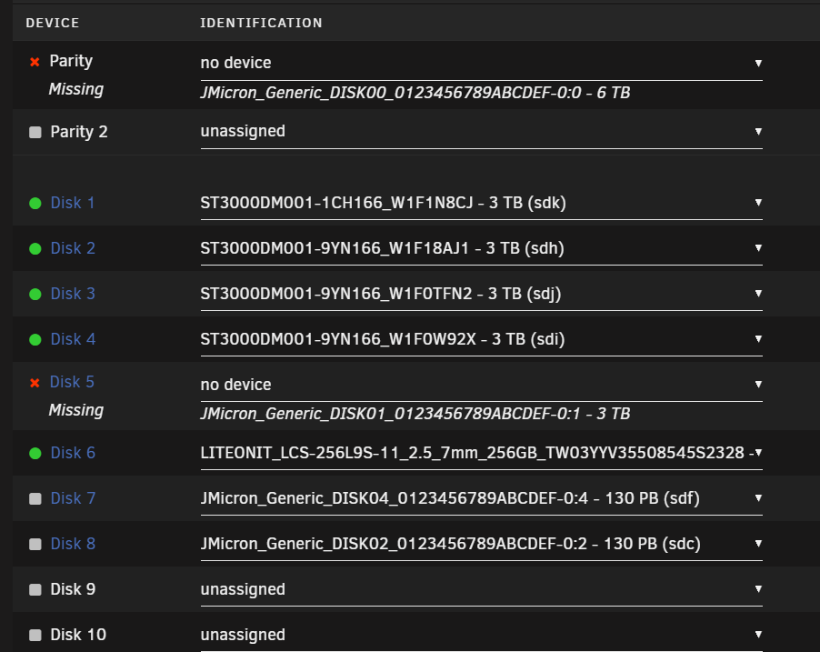

I have recently rebuilt and added on to my unraid NAS.
Most of my drives are 3TB, and the parity drive I set up is 6tb.
I don't know what happened, but my array spun down and I am seeing errors.
What should I be looking for here, and what are my next steps?

USB enclosures can change the disk names, one of the reasons they are not recommended for array/pool devices.
Would also be concerned about this:
Do you have any data on these USB disks yet? Do you still have the original parity drive, or any other SATA disk at least 3TB you could use as parity?
Best idea would be New Config without any USB and rebuild parity to a 3TB or more SATA disk, then if there is any data on the USB drives you could use Unassigned Devices to get to it.
That can't be right obviously. Wonder where Unraid got that number.
Also that 256G SSD, that shouldn't be in the array whether USB or not.

The 130 PB is what got my attention too. And of course, this issue happened during our ice storm here in Texas and I think we lost power for a couple of short periods.

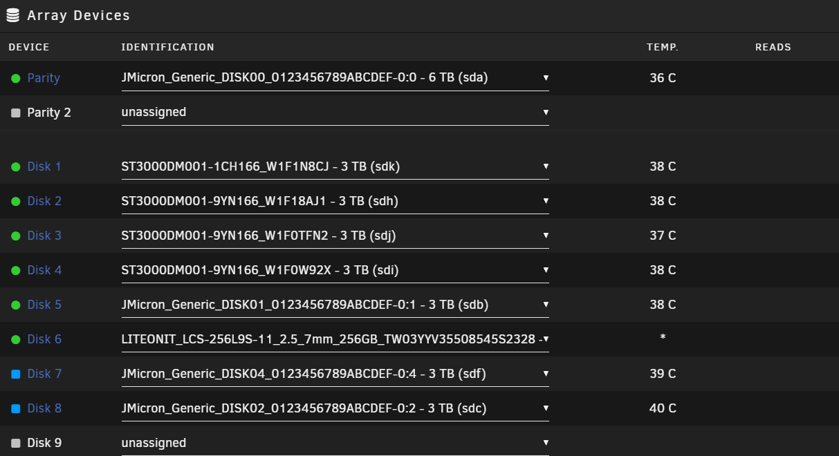

Alright! I pulled The usb enclosure, and reset the drives. Here's how it looks now.
I cracked open the server and confirmed I only have 4 spaces for drives which I am using the drives I had previously. They seem to still be up and available.
The question is what to do next.

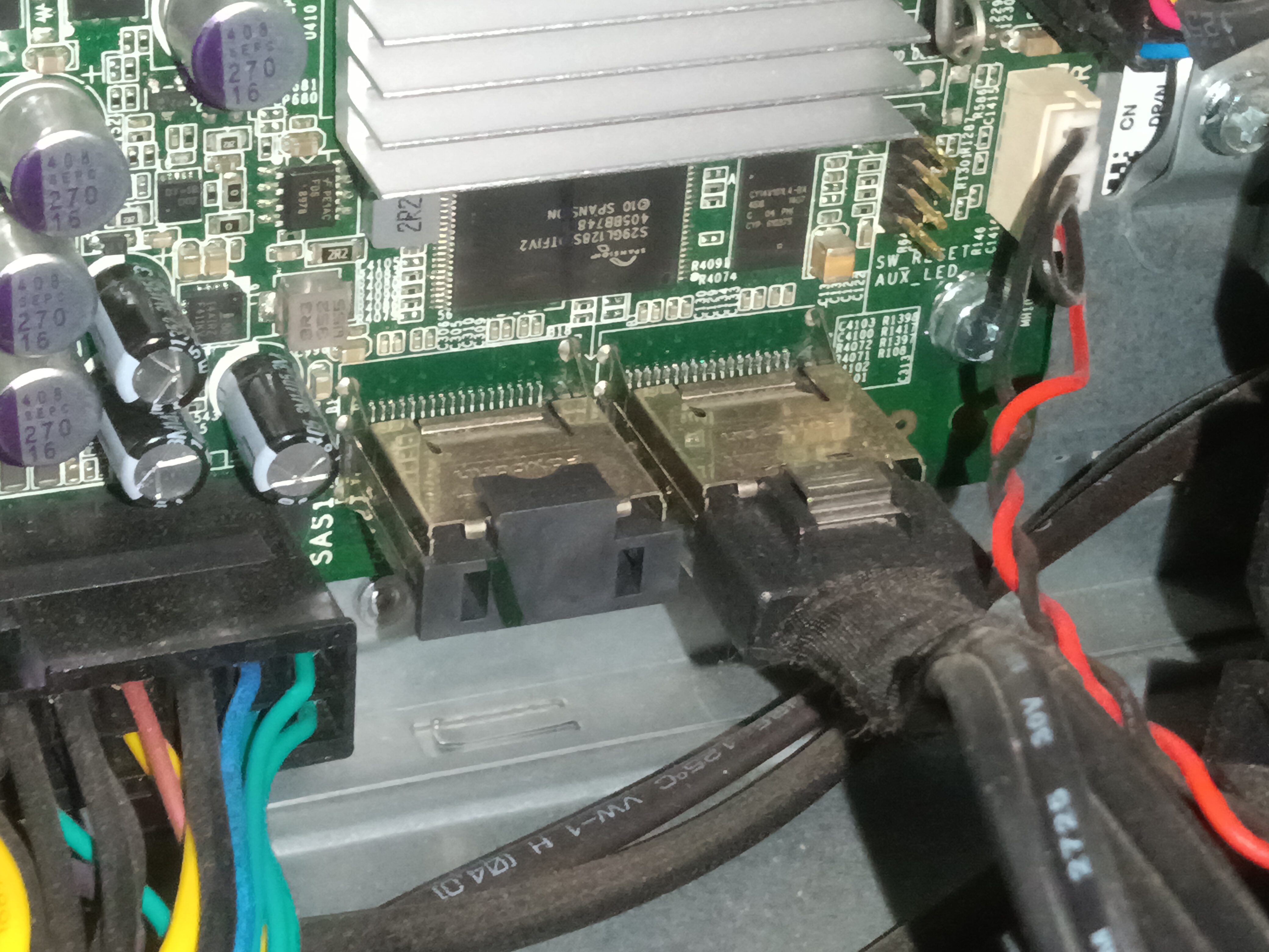

Do you have more SATA ports than you have drive bays?
It looks like there is an eSata port open. The other connects to the 4 drives I have already connected.

Just to confirm disks 7 and 8 are being detected as new disk and will be cleared if you start the array, are they new? I would really recommend getting rid of that enclosure or you will likely run into more issues in the future.
