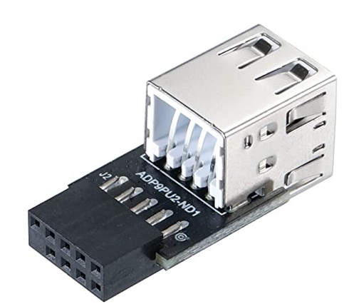

Much better to mount the stick inside the case, if your motherboard doesn't have a full size USB port on the board itself you can get a cheap adapter that converts from the 10 pin IDC header to a USB. Having the stick inside the case makes it much more difficult to accidentally damage or remove.

10 hours ago, JonathanM said:
Much better to mount the stick inside the case...
by using similar to this 9-pin motherboard header to USB 2.0 adapter
