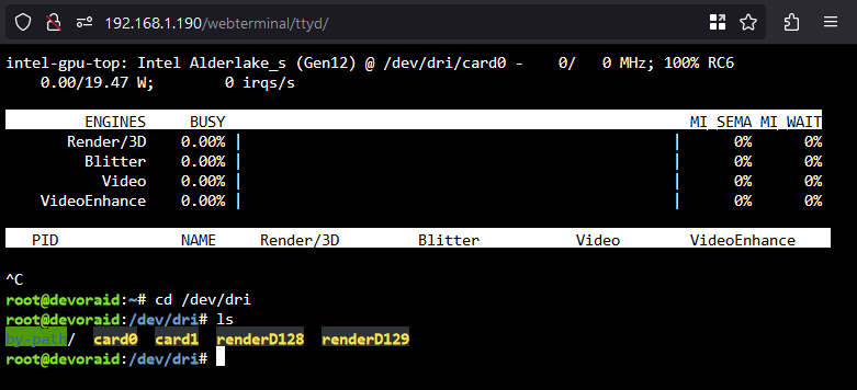

Unable to get 12700 iGPU / QSV to activate in any docker container
CPU: i7 12700 (non K)
Mobo: Gigabyte Z690 Gaming X DDR4
GPU: Nvidia 2080 Super
Unraid: 6.11.5
Bios: Latest, set to iGPU as main/boot GPU. PiKVM connected to motherboard HDMI port.
I've got NVENC working in Plex, TDARR, Unmanic, and Handbrake but I can't seem to get my iGPU to function in any docker container.
I've installed Intel GPU TOP.
modprobe i915 returns nothing, so no errors there.
intel_gpu_top shows the iGPU is detected. Navigating to /dev/dri shows card0 and card1.
I have tried starting containers with extra parameter "--device=/dev/dri", and i have also tried adding a device to the container (though this seems outdated and no longer necessary?)
Every single container, Plex, TDARR, Unmanic, and Handbrake fail to utilise the iGPU. Plex ignores it and falls back to CPU transcode. TDARR and Unmanic fly through transcodes at 30,000FPS and fail -- intel_gpu_top shows 0% utilisation. Handbrake fails to initialise QSV.
What am I doing wrong here? Is my PiKVM causing issues? Are you meant to boot headlessly in order for iGPU to work properly in Unraid?
I have not seen anyone make reference to "card1" when reading through other threads across reddit and unraid, mostly every screenshot and tutorial i've seen only shows card0.

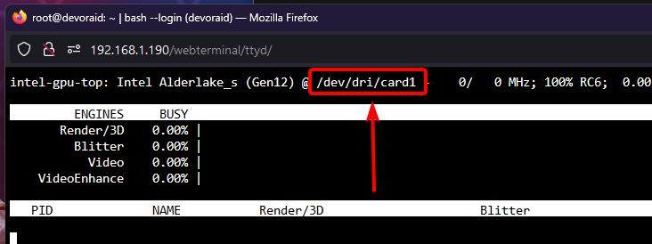

You will first need to open terminal and run intel_gpu_top to confirm what your iGPU's identifier is (card0 or card1). In the below screenshot my iGPU is card1/renderD129, which means my Nvidia GPU (by process of elimination) is card0/renderD128.

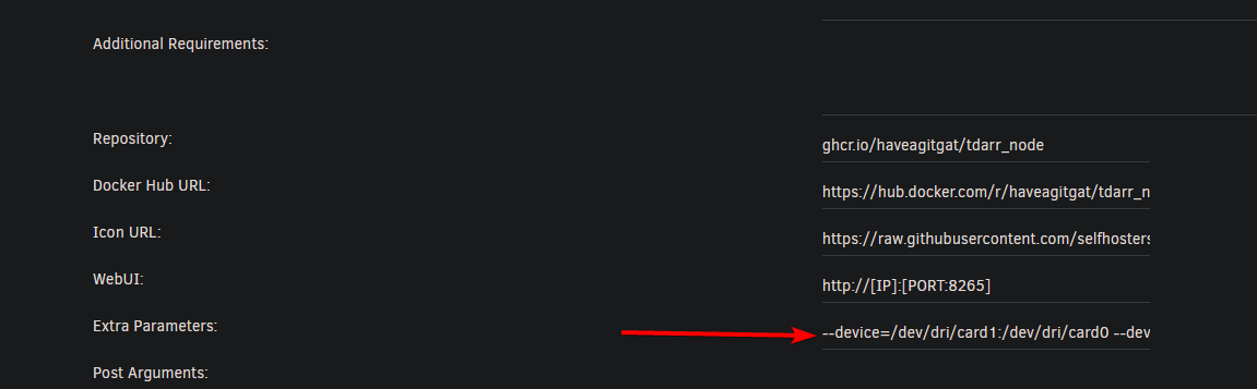

Next edit your docker container and enable advanced view. Under "Extra Parameters" enter the following command.
In my case i am directing card1 to card0 and renderD129 to renderD128 in order to stop docker from targeting my Nvidia GPU when trying to run QSV operations.
--device=/dev/dri/card1:/dev/dri/card0 --device=/dev/dri/renderD129:/dev/dri/renderD128

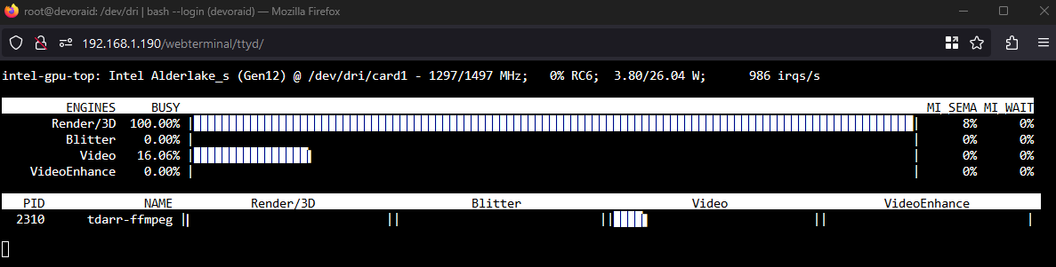

Once you've saved, run a test and you should see activity on your iGPU.
