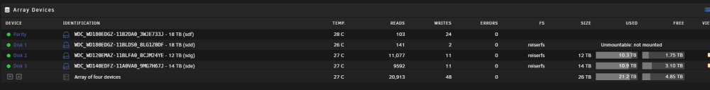

Long-time Unraid user here first time I've ever had an issue with a drive.
My server spent the last 5 days preclearing and building a brand new 18TB WD Drive from parity to replace a 10TB Drive.
Preclear and Parity build completed yesterday with no errors.

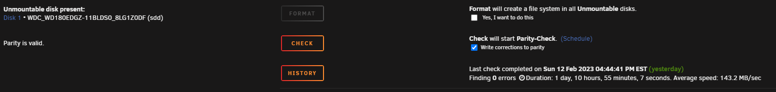

I got up this morning and see that the same 18TB Drive is now unmountable.
   Where do I go from here?  I have the original 10TB Drive, it's still in the server but unmounted.
In looking thru SysLog I see this:
Feb 13 11:21:56 MediaTower kernel: REISERFS warning (device md1): journal-1207 journal_read_transaction: REPLAY FAILURE fsck required! Block to replay is outside of filesystem
Feb 13 11:21:56 MediaTower kernel: REISERFS warning (device md1): reiserfs-2006 journal_init: Replay Failure, unable to mount
Feb 13 11:21:56 MediaTower root: mount: /mnt/disk1: wrong fs type, bad option, bad superblock on /dev/md1, missing codepage or helper program, or other error.
Feb 13 11:21:56 MediaTower kernel: REISERFS warning (device md1): sh-2022 reiserfs_fill_super: unable to initialize journal space
Feb 13 11:21:56 MediaTower emhttpd: shcmd (30): exit status: 32
Feb 13 11:21:56 MediaTower emhttpd: /mnt/disk1 mount error: not mounted

6 minutes ago, a12vman said:
It shows up down in unassigned devices
What shows up as Unassigned? Your screenshot is showing Array Operation, not Unassigned Devices.
Disk1 isn't disabled, it is just unmountable.
Diagnostics are after reboot so can't see what happened before. Might be a good idea to check connections.
Then check filesystem on disk1.

Reiserfs cannot handle drives larger than 16 TB (one of the reasons it is now deprecated) so that may be the cause of the problem.   For drives of the larger sizes now available you need to use XFS or BTRFS (or ZFS when Unraid 6.12 is released) as the file system type.
