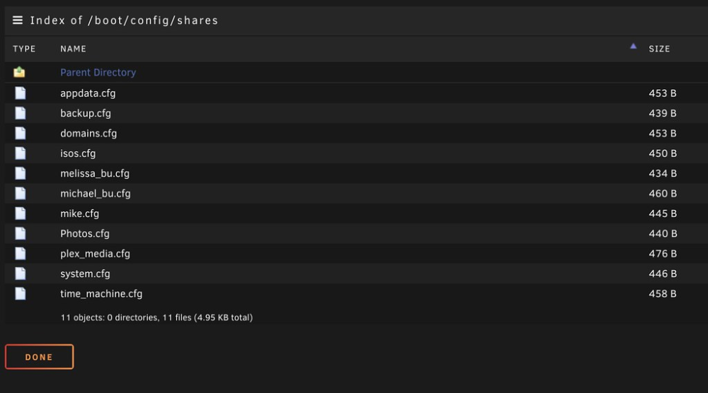

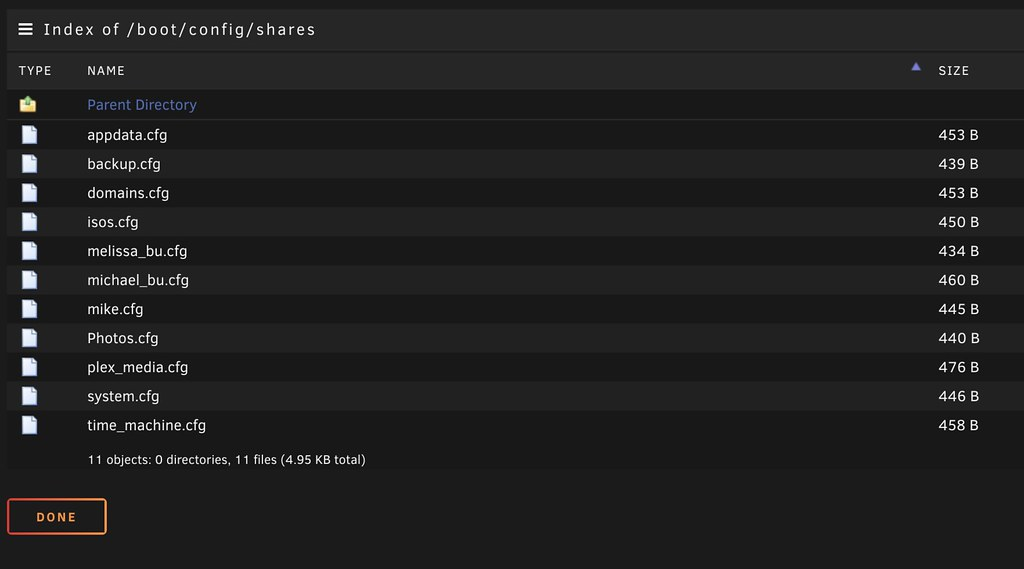

I upgraded the m.2 cache drive, and I just sent it, I didn't do a backup and now the old drive is formatted.  I screwed up. I no longer have any shares setup.
I see the share config files on the USB though, so Im wondering if there is a way to recover the share/user info off of the usb and back onto the cache.

A User Share is just a combined view of the top level folder corresponding to the share name across all array drives and pools.  It is not tied to the cache drive in any way.   You still seem to have share configuration files intact so in that sense the information for them is still there.
If you meant you have lost the content of the parts of the shares that were on the flash drive then unless you have backups elsewhere that content will be lost.

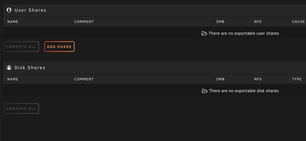

Yeah, sorry.. All I did was replace the cache drive with a larger nvme.  Started everything up, shares are missing.  I was thinking that the share configs were stored on the cache drive as a result.. Any idea why the shares are missing now?  I was going to just wait for the parity to finish rebuilding and then reboot and recheck, but Im sleep deprived and a little spun out right now.

The share configs ARE stored on the flash drive.    What shares are missing?
image.thumb.png.c9016fbc46fff3974a4d697d1a00e89e.pngimage.thumb.png.b74efd459c4b6ab075049ef42174d071.png
Have you tried rebooting?   If not then I suggest doing so and if the problem persists post new diagnostics taken after the reboot.
Another issue is that you not on the latest Unraid release and the one you are on has a bug that does not give us much information on shares in the diagnostics.
