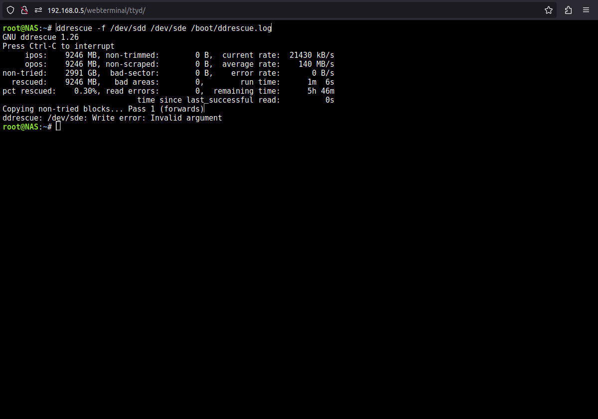

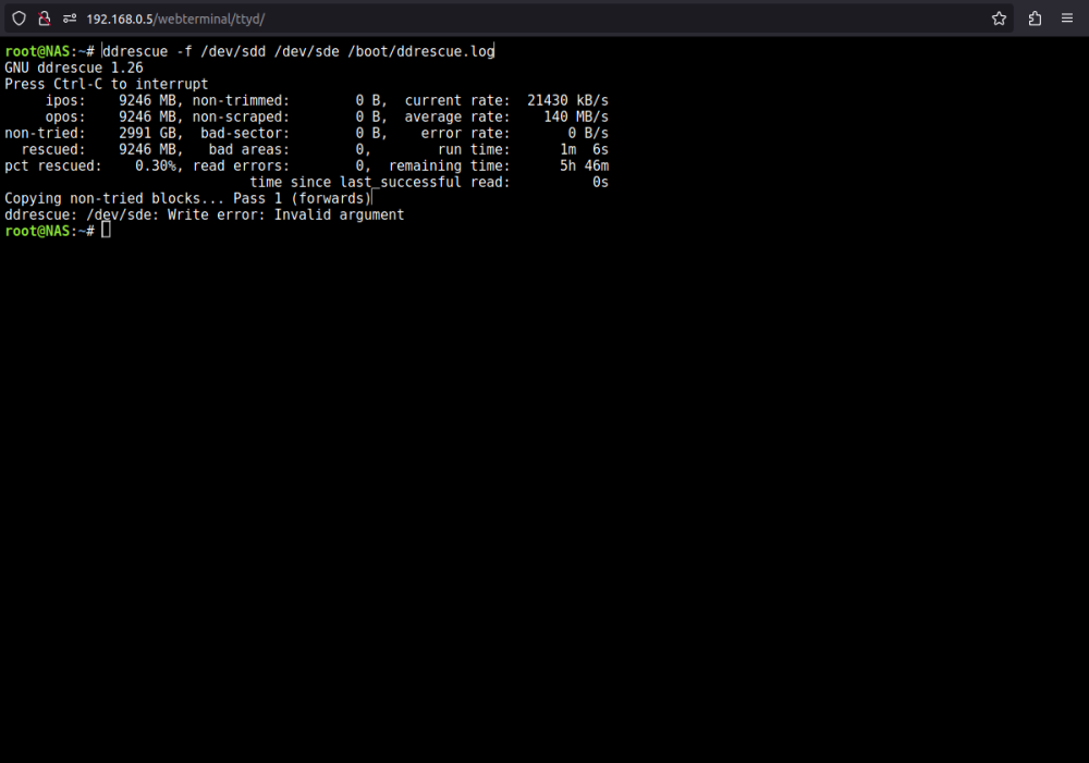

Ok so I got a cable for my other sata6 SAS conector on my add in card and hooked up the replacement hdd to it. I tried running DDrescue and got the attachment. I am currently running an extended self test on the disk, it was shipped to me in a bag, not box, no packing ugh.
