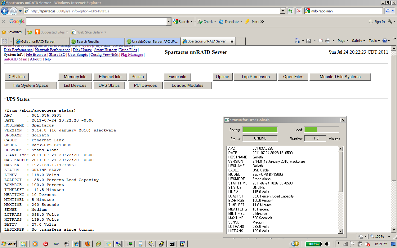

July 28, 201115 yr Same here, John. I've installed on several versions from pkg_manager. Installed as slave just now on b10 using these parameters: Uploaded with ImageShack.us[/img] Syslog after reload: Jul 27 20:52:05 Tower1 apcupsd[20849]: apcupsd exiting, signal 15 Jul 27 20:52:05 Tower1 apcupsd[20849]: apcupsd shutdown succeeded Jul 27 20:52:07 Tower1 apcupsd[22338]: apcupsd 3.14.3 (20 January 2008) slackware startup succeeded Jul 27 20:52:07 Tower1 apcupsd[22338]: NIS server startup succeeded Pulled power cord of master's UPS and slave's UPS Info shows:

August 6, 201115 yr Author Actually, I did have it as IP. but thanks for the suggestion I looked at Cyrnel's screenshot and noticed his config file does not match mine. Even though I only added unmenu about 2 weeks ago, I ran the check for updates option today and i then got the new config layout. I put in my data and everything is good. Thanks for the help. I guess the answer was already put into place, i just didn't have the update. ~shrug~
