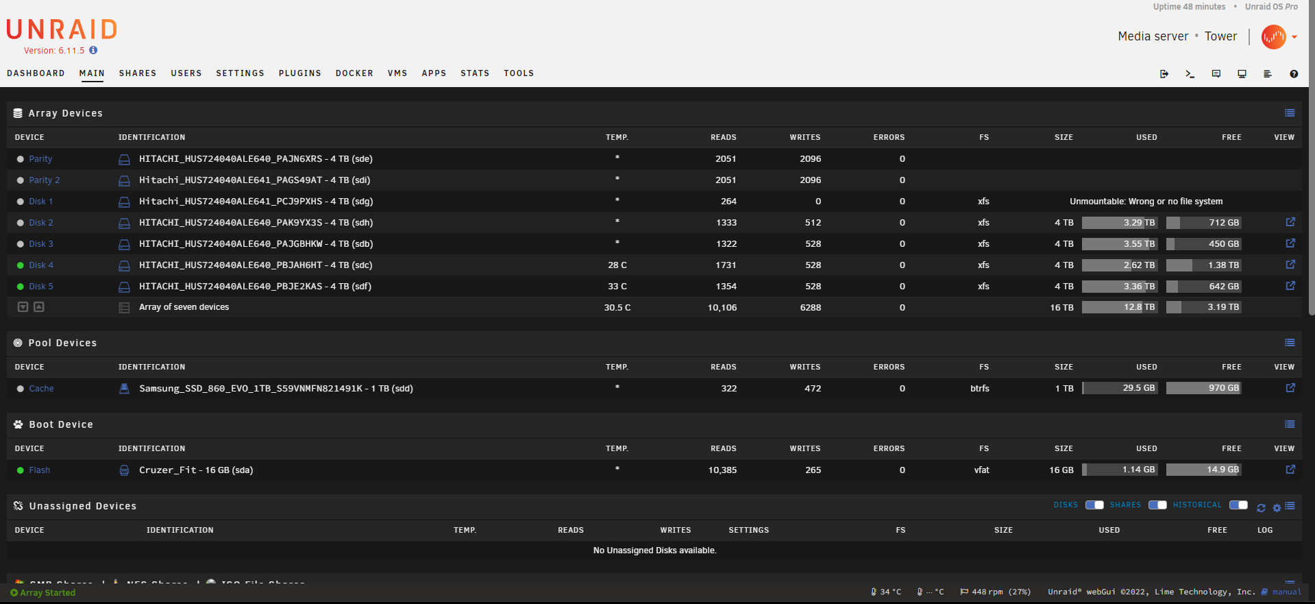

Good Morning,
I recently had a drive fail on disk 1 and replaced it with a new drive as well as a 2nd parity drive. Mounted everything and rebuilt the array without issue. i did have some weird docker memory full issue that i was able to clear up. i've tried "xfs_repair -v /dev/md1" already and that didn't help. Any help is greatly appreciated. Thanks! 1774769501_Tower_Main-GoogleChrome2_20_20237_54_20AM(2).thumb.png.7afb2080efd7859b5e70f16d3d92c9fd.png

What was/is the output from the xfs_repair?   I would expect it to give an indication of why it is not working.
Not sure what the error was, but i tried again after a reboot and everything working great now!
You have to start the array in normal mode to see the results of the repair.
Rebooting started the array in normal mode.
Perhaps you still have problems you haven't noticed.
Attach diagnostics to your NEXT post in this thread
if you want us to take a look.
