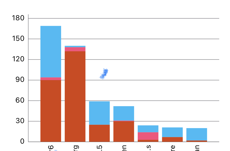

For the most part you are correct.  Transcoding is usually used to save bandwidth or convert the file if it is not supported by your player.  The graph included is my Users I am the second line.  Blue is transcoded media pink is Direct Stream (changes the file container) and red is Direct play (no transcoding at all).  You can see the second bar has almost no transcoding which is on local network.
