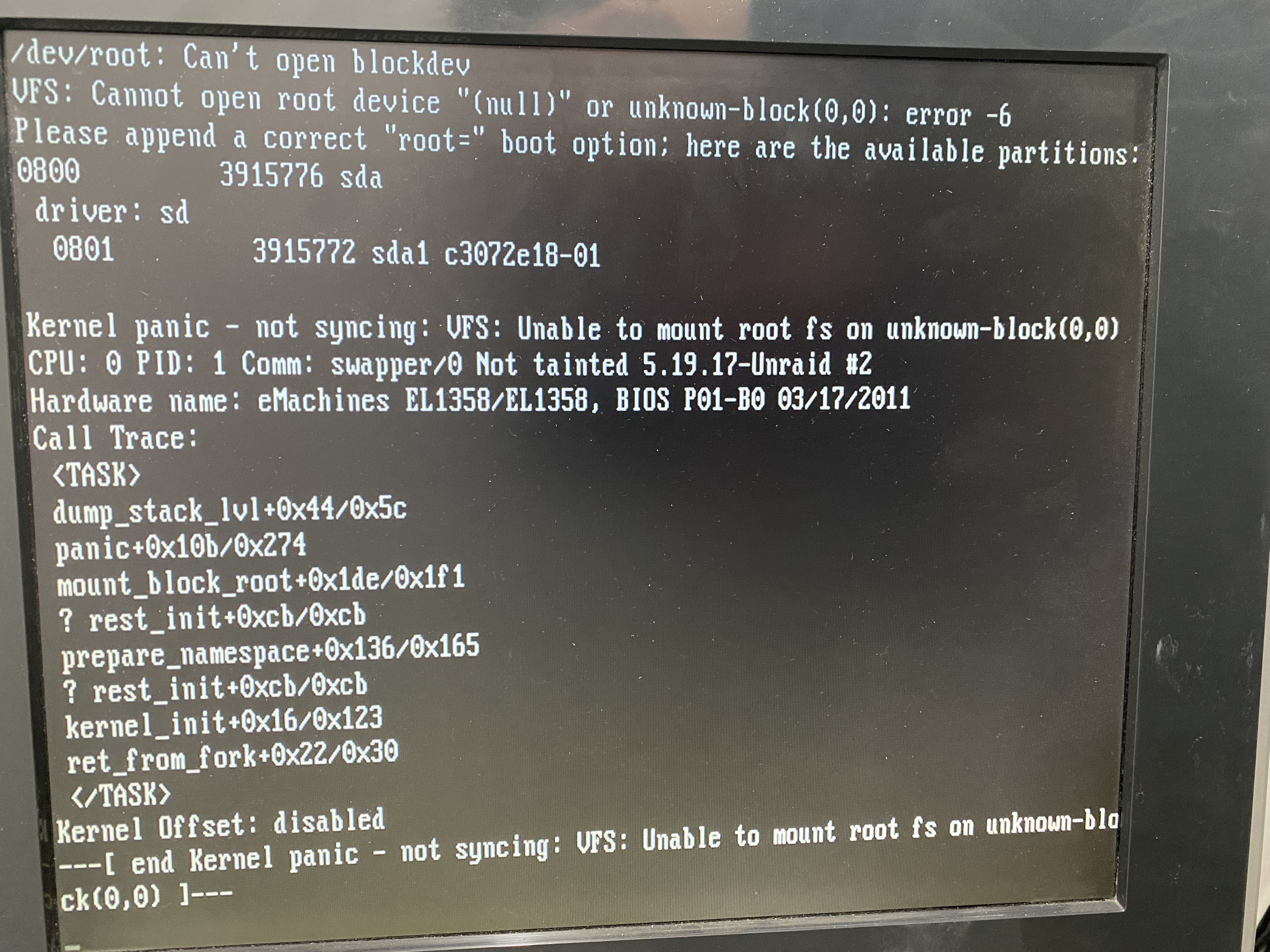

I just updated from 6.5.x to 6.11.5. on reboot I'm getting a kernel panic.
Attached is the error I'm receiving.
I have no idea how to proceed

I tried unplugging all the disk drives and booting with the original flash drive. Without the drives plugged in, I'm getting to the same error that I got originally
If I try to boot a new installation with the old config file folder and no disk drives plugged in, I get to the original error.

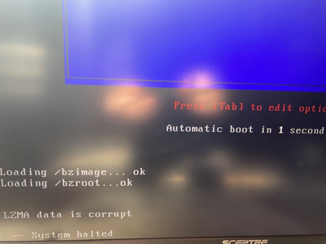

If I try to boot a new/unedited flash installation with the disk drives unplugged I get to the unraid boot menu, but get this error when I try to boot - LZMA data is corrupt
I ran the memtest - came back with no errors
