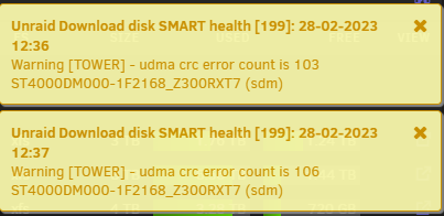

I am now seeing UDMA CRC errors not sure if it is a cable issue now its on that same drive i was seeing the reallocated sectors on before.image.png.2c6d6f58845284472bb86fe0407f156e.png
Edited by Maticks
Those are usually a SATA cable problem.
