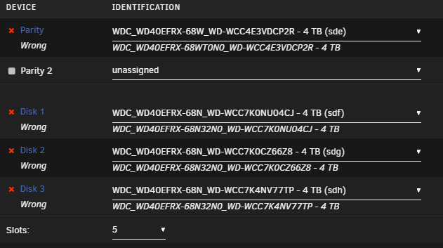

I have moved my disks to a new server and unfortunately because I am using a different RAID card (in HBA mode), it identifies the hard disks from the array with an extra couple of characters - which means all my disks are listed as wrong.
I am 99% sure that this is the correct fix, but just wanted someone to reassure me...
I plan to set New Config (tools -> New Config) and "Preserve Current Assignments" to none.
As far as I remember, this should allow me to assign the disks back to their correct slots and all my data should be available again - I cant remember if this forces a new parity check or not... but will, of course, make sure that the parity disk assignment is correct ;-)
Any comments appreciated.
Thanks

Thanks @BRiT thats good advice... I have s creen shot of the original disk assignments, so am 100% sure the disks 'will be' correctly assigned but will do that as an extra precaution... I'll just wait for any more comments before carrying out a "new config" operation.
This is what the array now sees the disks as, just as an FYI...

OK, I assigned the disks (except the parity) and started the array... and it all looks good, so I am happy that this is the correct method and will re-assign the parity drive now.
