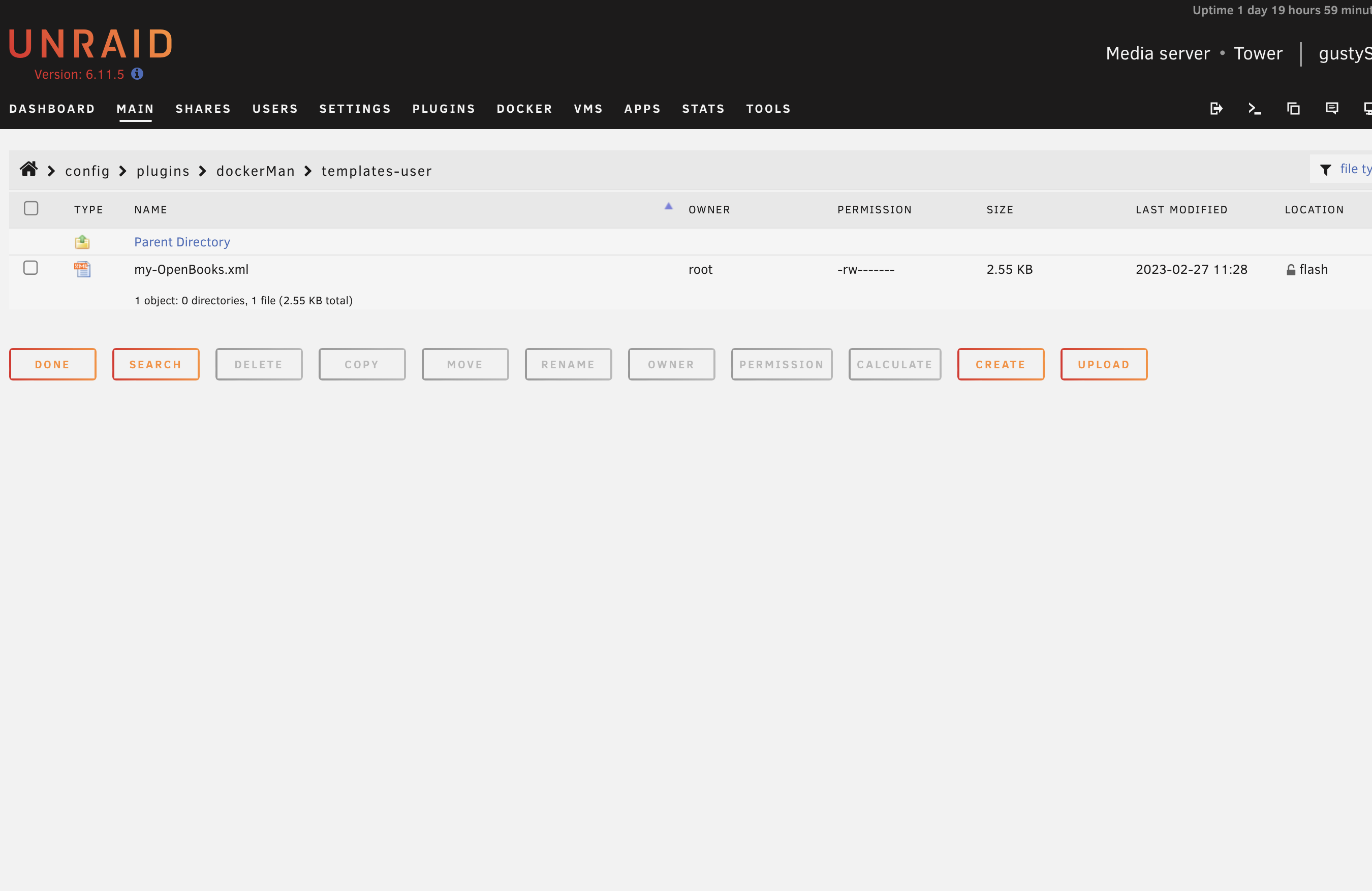

I have a new Unraid server setup. I spent a lot of time setting up my docker applications.
I went to update one of the dockers I setup but it fails due to "Configuration not found. Was this container created using this plugin?"
I found out this is due to my config files missing from my flash drive. I do not know how they could be missing from my flash drive as this was working this morning, and is no longer working now. I do not see my configs (except for a single, most recently created one).
What can I do about this? Am I screwed and do I need to restart my docker setup so these config files exist again? Why were they removed in the first place (so this doesn't happen again).
