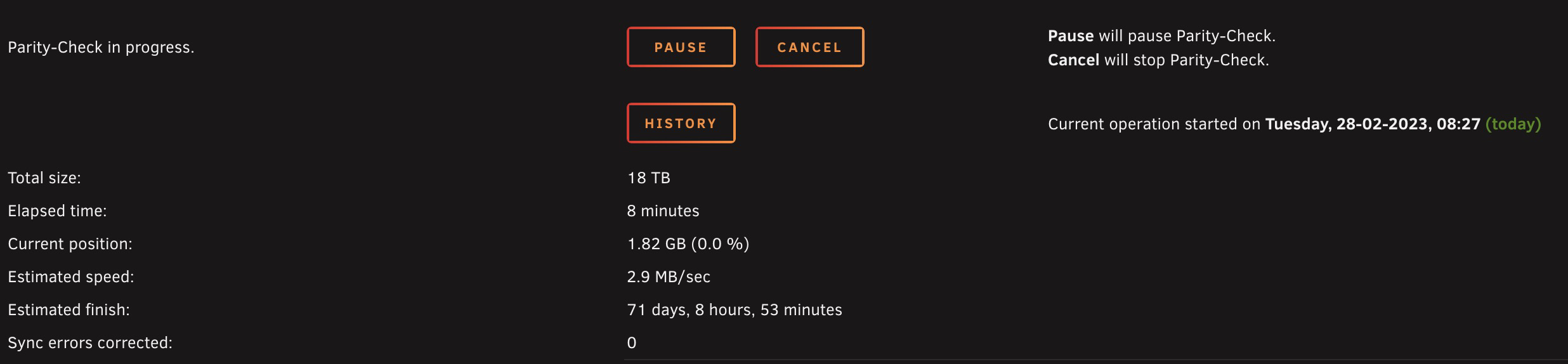

I have started to get super slow parity sync speeds (~2MB/s)
Have been scratching my head on this one for a while and my syslog does not look like any other i have seen on similar support threads.
I have run a Disk speed benchmark and even though some disks are slower they are nowhere as slow as the parity sync.
I am hoping there is someone here who has a better understanding of whats going on then me :)

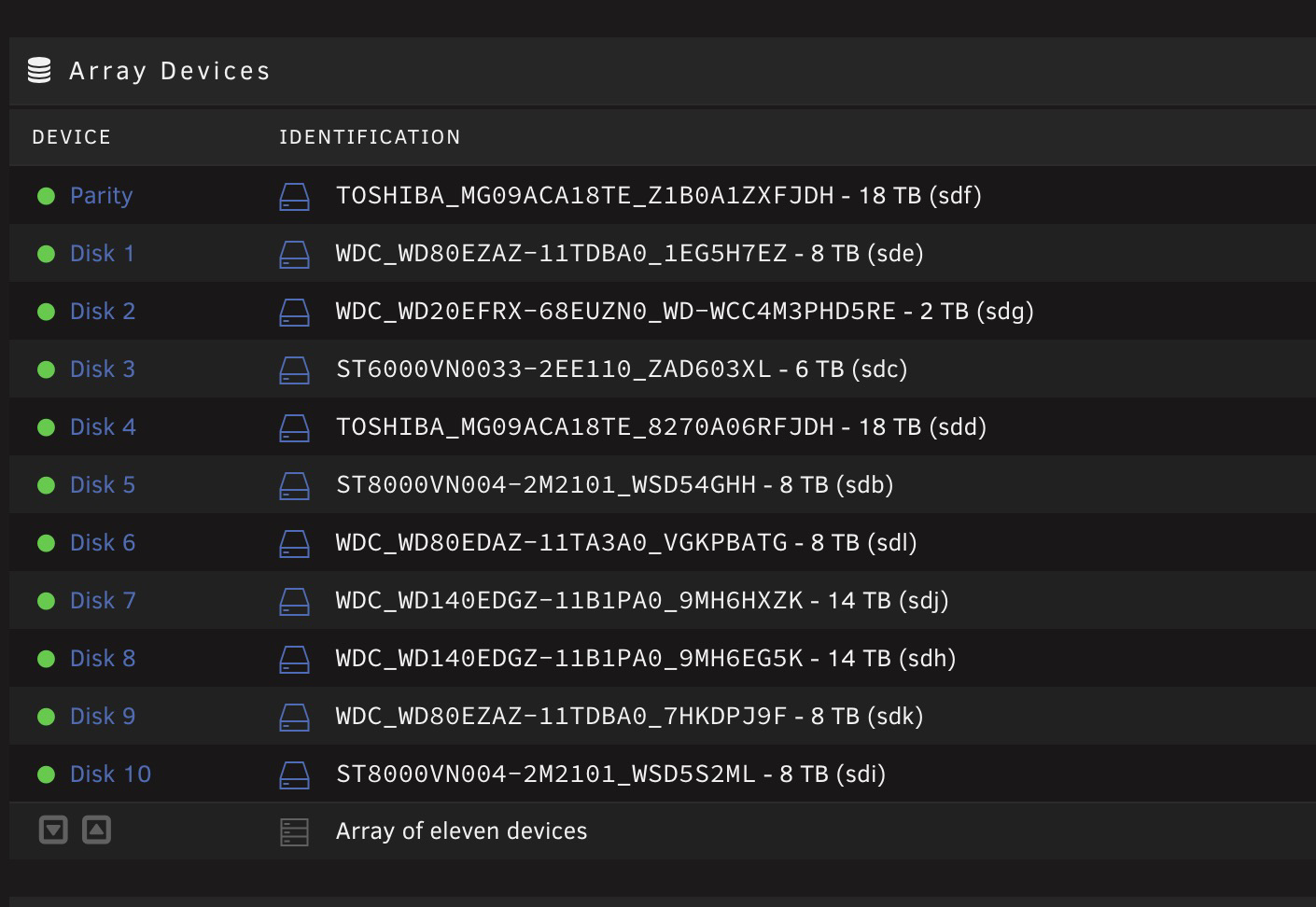

What more information/logs would be needed to determine which disk is the problem?
If you click on the option for each drive on the Main tab to show the log (under the IDENTIFICATION column) I think it will be obvious which one is generating these messages.
Is it this that you mean?
The disk icons are clickable, that's where the log is.
Oh damm, i never knew that icon did anything, only knew the disk text was clickable
