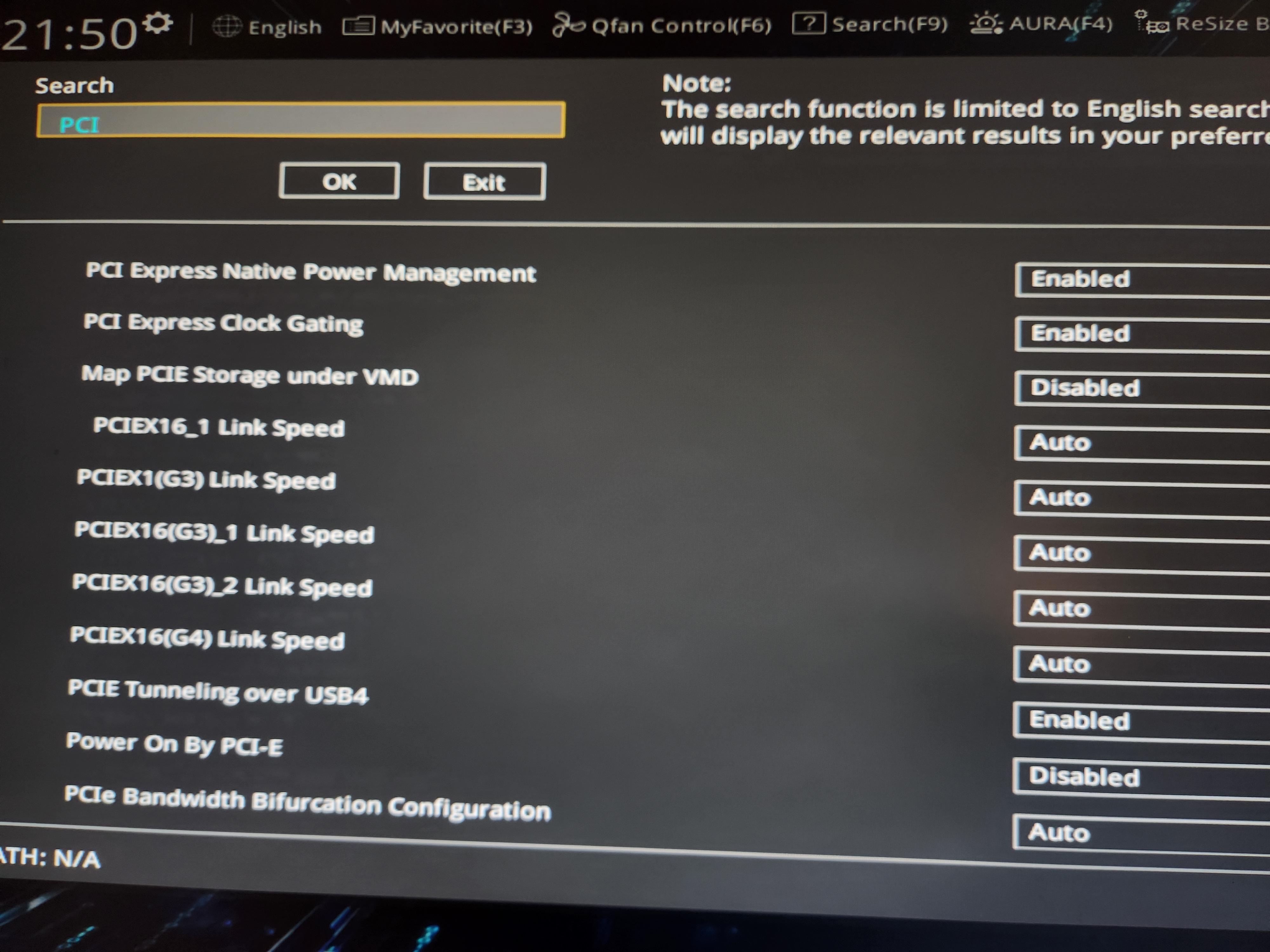

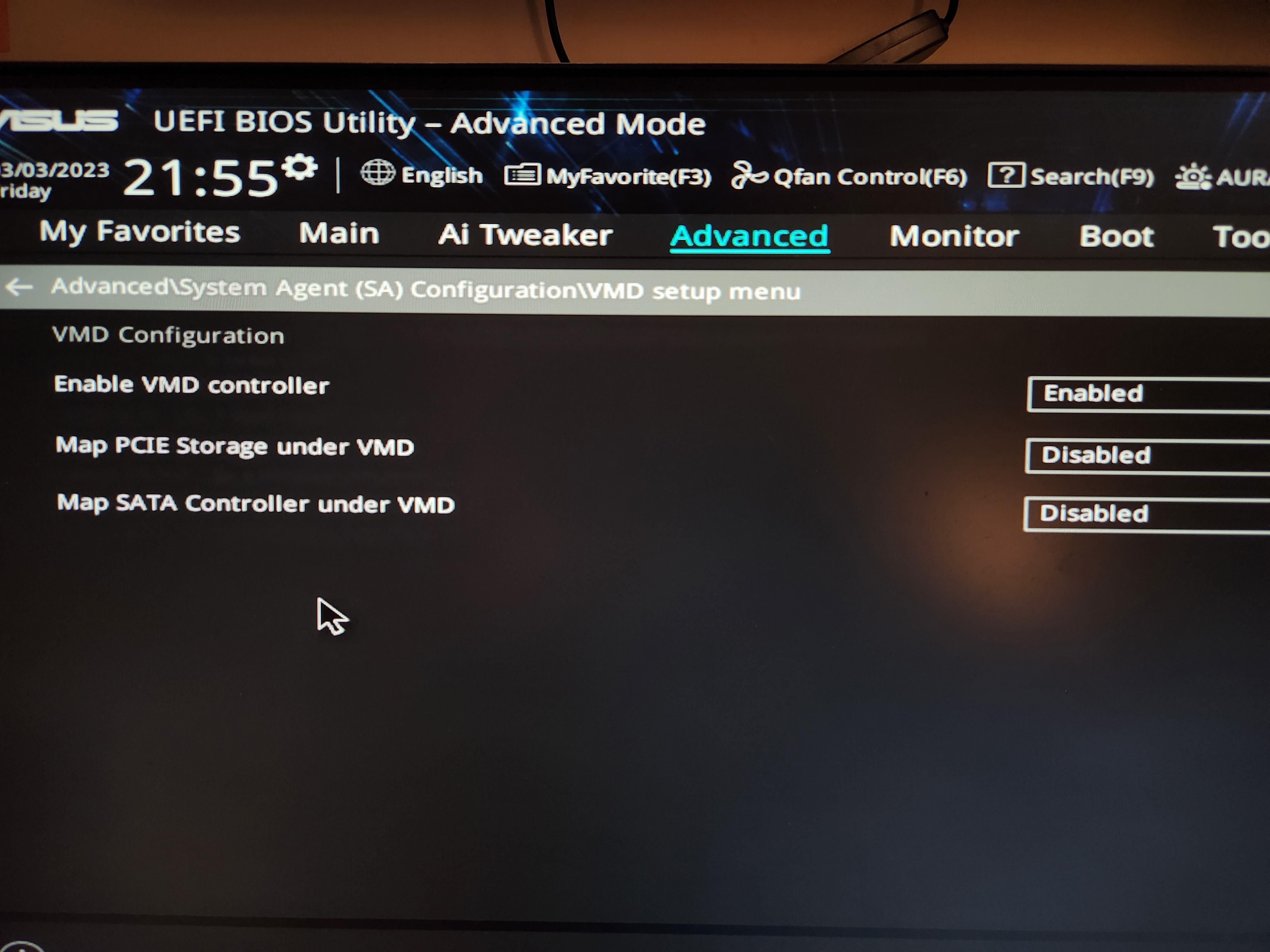

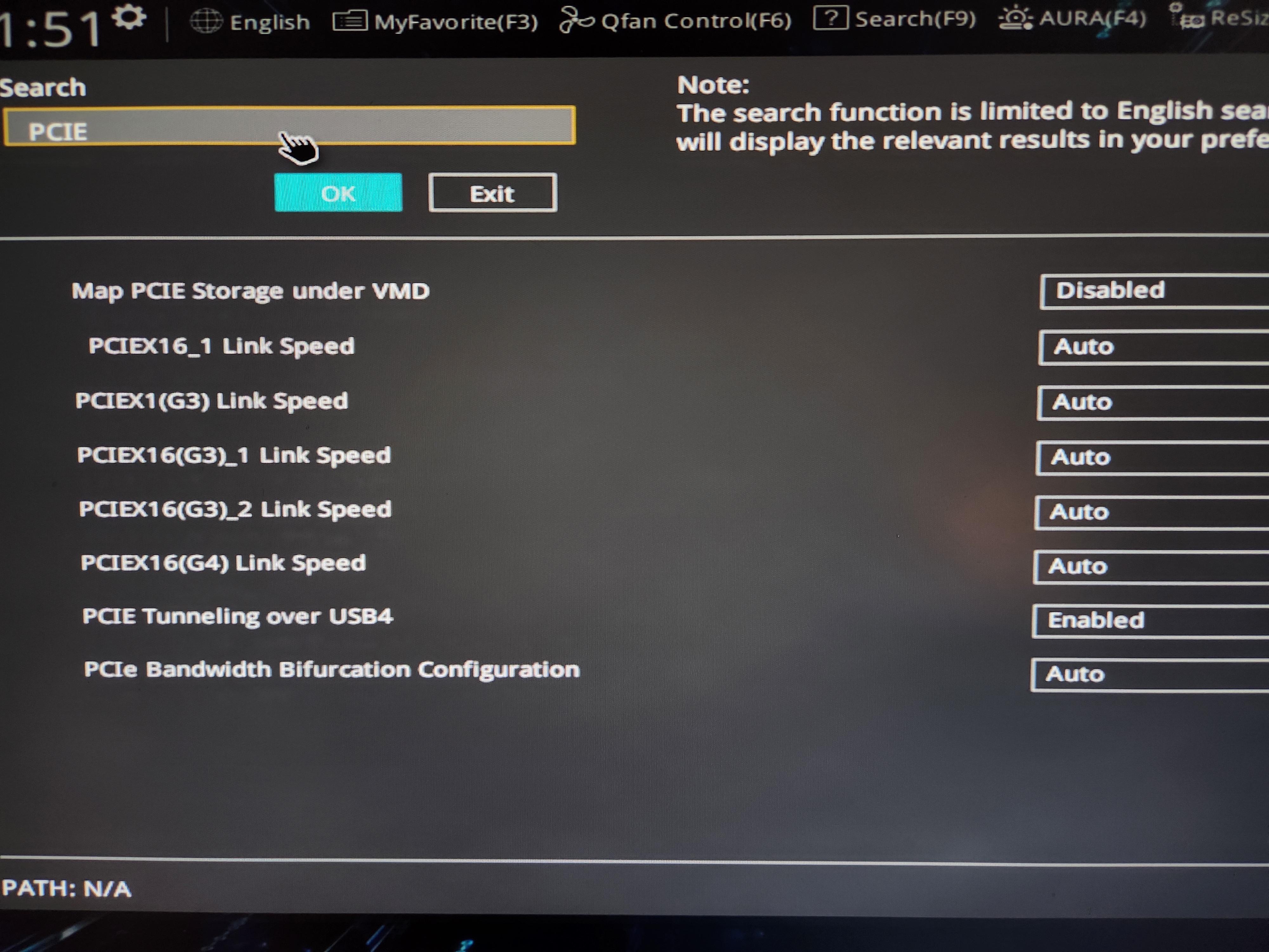

This is what’s in my bios. Am I missing anything

The controller is not being detected by Linux, this is not a software problem, try a different PCIe slot on the board, also look for a BIOS update, if nothing helps it might be a compatibility problem between the board and the controller, try a different model if possible.
