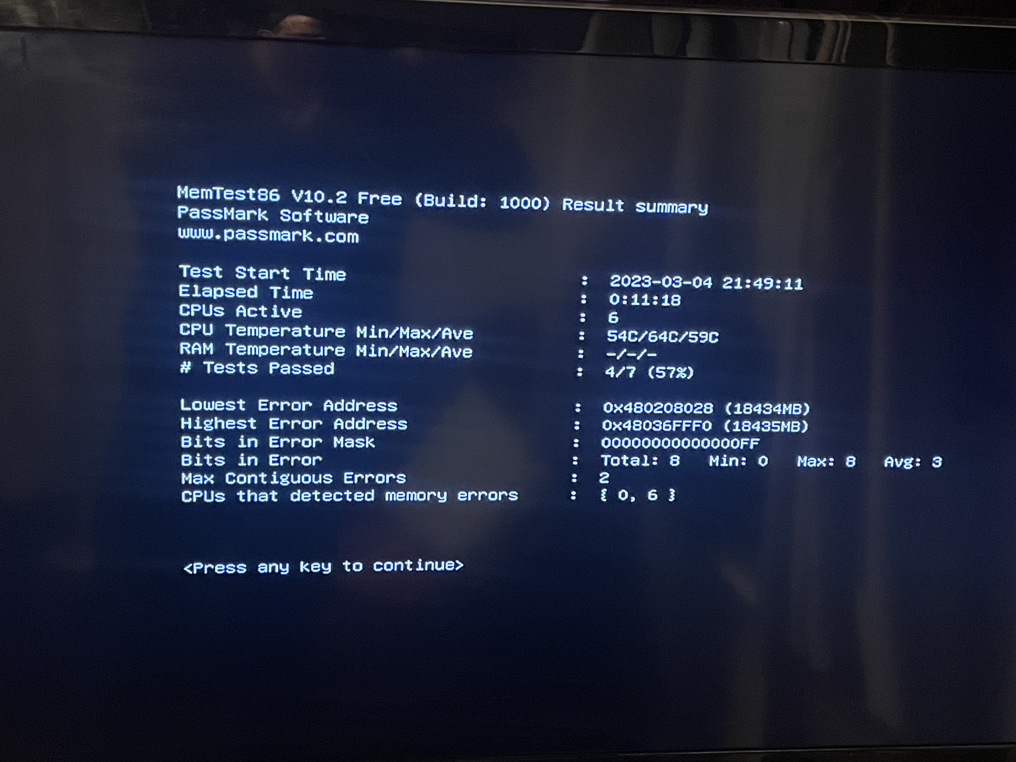

With multiple apps segfaulting I would start with memtest.
Cheers @JorgeB I’ll give it a go.
interesting problem though for some reason my keyboard doesn’t work at the Unraid boot section to select MRM test. It works to access the bios but it doesn’t recognize when I select “TAB”.
I might have to download the memtest onto a separate usb stick and try and run it independently

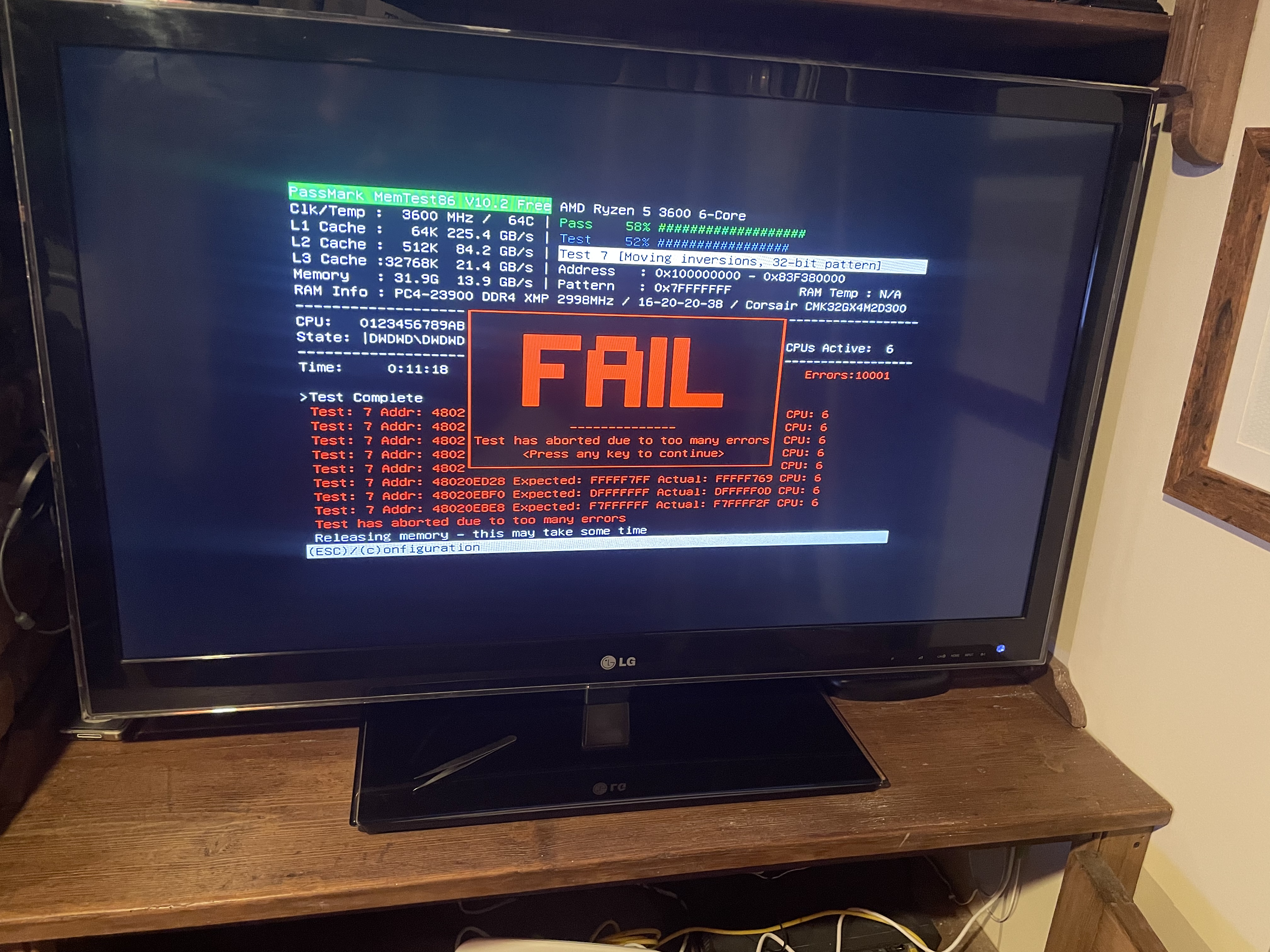

I’d be surprised if the ram is bad though as I bought it new and it’s Corsair Vengeance LPX 32gb (2x16gb) DDR4 3000 MHz which does have a lifetime guarantee however.
Yup! That’ll do it I guess !
I’ll see if I can get them replaced:-
