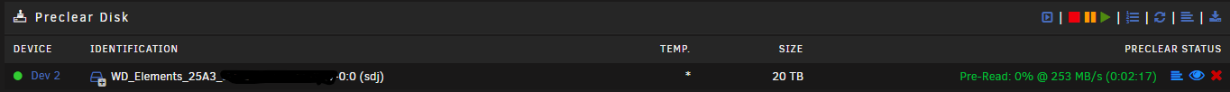

  2. Hi, I'm hoping someone can help me out ? I've started to pre-clear two new 20TB WD element drives beofre I shuck them. Both failed (But i think this is because they Overheated, they got to 52c). I've tried to preclear again one at a time, but preclear is stuck on "Starting", I've tried rebooting the server and using different USB ports (They only work on the ports I first used, the others cant see the drives). Any help would be great as I'm fresh out of ideas. Thanks D. Added the preclear logs, but they dont say much NEO-unassigned.devices.preclear-20250403-1210.zip

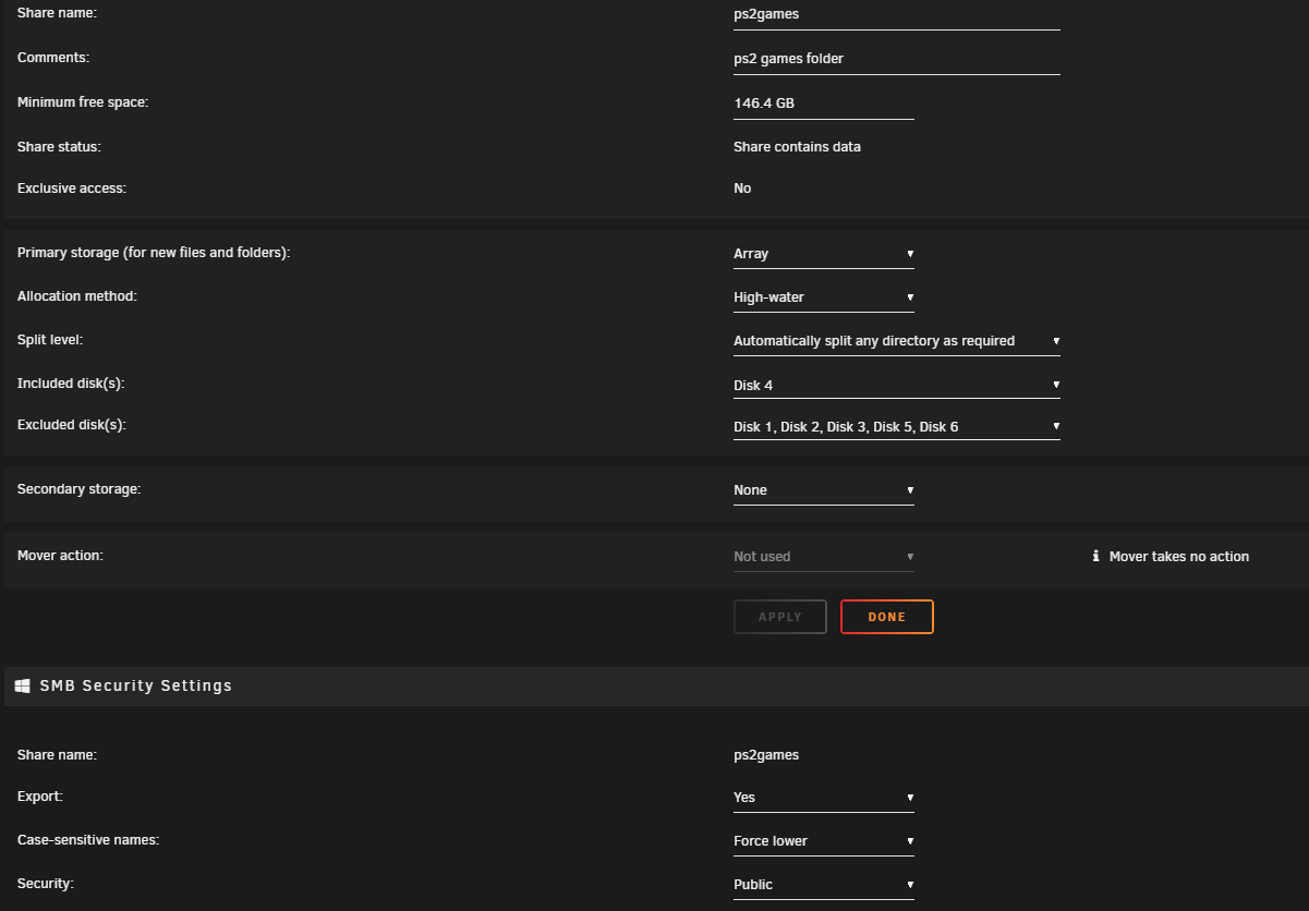

  8. Hi, Yes, here are my share settings (I've just tried forcing lower case). I think it needs to be SMB 1 for the PS2 to connect. Here are some settings I've found from another post here:- OPL SMB Configuration Guide [global] client min protocol = CORE client max protocol = NT1 server max protocol = SMB3 server min protocol = LANMAN1 strict sync = no keepalive = 0 Its a bit old though

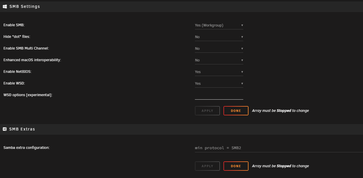

  9. Hi, Looks like Netbios is already turned on ! Heres a shot of my settings, does anything else stand out ? Maybe the SAMBA extra config line ?? Any chance You could share your SMB settings so i can see if I've missed anything obvious. Cheers D.
  10. Ok, no bear with me I’m trying something new here I’m hoping some else has succeeded in getting to work. I have an old PlayStation 2 and have for my hands on a network adapter for it and Free Mcboot (this has an app called OPL) that allows you to play PS2 iso games over a network. a perfect use case for Unraid I thought. now there’s some chatter on the net that it only works with SMB 1.0. There some chat it works with SMB 2/3.0. has anyone else Here managed to get it to work. When I put all the details in it says it cannot log into smb share (which means it sees it, just can’t login). any pointers much appreciated. I’ve created a share and a user account to access it. All lowercase and no hyphens just to be on the safe side. Still can’t get OPL to log in. Cheers All.
