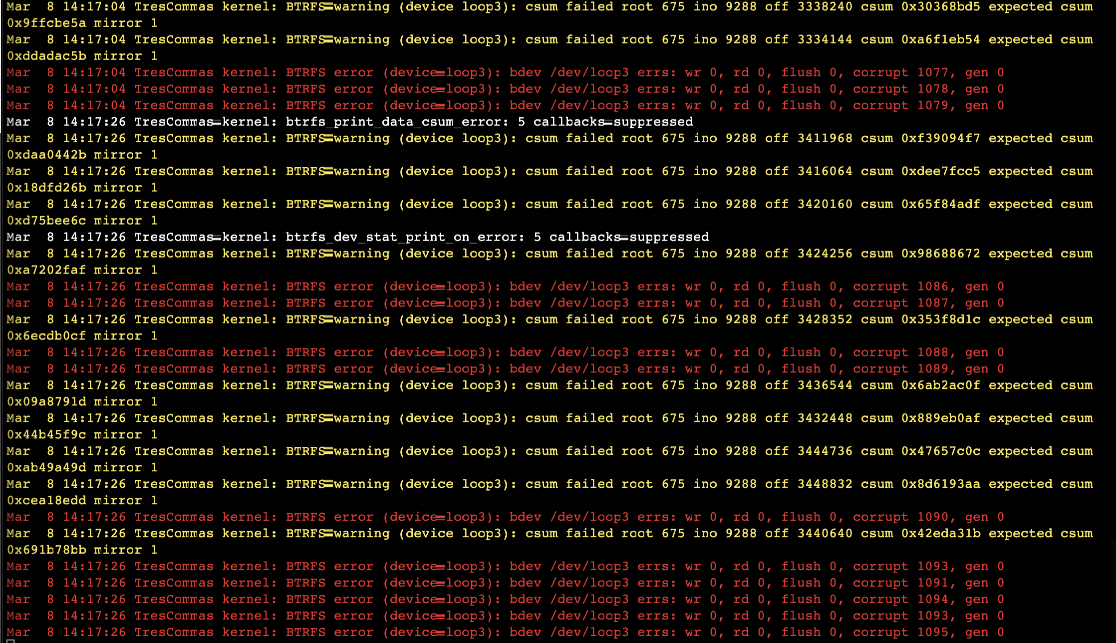

I've been experiencing a litany of issues with my server, seemingly around cache drive corruption.  I formatted the drive several times before buying a new one and installing it.  After two days, I'm starting to get errors seen in the below screenshot.  What is happening?  I don't see an issue with my applications yet, just trying to get ahead of whatever this may be.

Mar  8 10:12:21 TresCommas kernel: ata6.00: exception Emask 0x10 SAct 0xc0000 SErr 0x4890000 action 0xe frozen
Mar  8 10:12:21 TresCommas kernel: ata6.00: irq_stat 0x08400040, interface fatal error, connection status changed
Mar  8 10:12:21 TresCommas kernel: ata6: SError: { PHYRdyChg 10B8B LinkSeq DevExch }
Mar  8 10:12:21 TresCommas kernel: ata6.00: failed command: READ FPDMA QUEUED
Mar  8 10:12:21 TresCommas kernel: ata6.00: cmd 60/98:90:b0:4a:0b/00:00:68:03:00/40 tag 18 ncq dma 77824 in
Mar  8 10:12:21 TresCommas kernel:         res 40/00:00:e0:c5:29/00:00:d5:00:00/40 Emask 0x10 (ATA bus error)
Mar  8 10:12:21 TresCommas kernel: ata6.00: status: { DRDY }
Mar  8 10:12:21 TresCommas kernel: ata6.00: cmd 60/80:98:78:3c:7f/00:00:68:03:00/40 tag 19 ncq dma 65536 in
Mar  8 10:12:21 TresCommas kernel: ata6: hard resetting link
Mar  8 10:12:27 TresCommas kernel: ata6: link is slow to respond, please be patient (ready=0)
Mar  8 10:12:31 TresCommas kernel: ata6: COMRESET failed (errno=-16)
Mar  8 10:12:31 TresCommas kernel: ata6: hard resetting link
Mar  8 10:12:35 TresCommas kernel: ata6: SATA link up 3.0 Gbps (SStatus 123 SControl 300)
Mar  8 10:12:36 TresCommas kernel: ata6.00: supports DRM functions and may not be fully accessible
Issues with disk3, check/replace cables, also a good idea to recreate the docker image on cache instead of disk3.

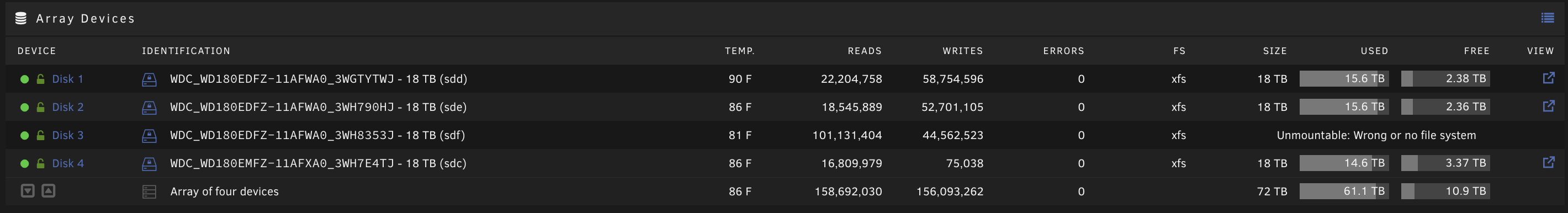

I turned the array off to rebuild the docker image, then I didn't have an option to delete the vdisk and create a new docker img.  When I turned the array back on, my disk3 is now reporting as unmountable.  What's my next logical move here?

Booted to maint mode, tried a Check Filesystem Status -nv and got the following:

That is quite standard, you need to rerun it adding the -L option (and without -n for any changes to be made).
Thank you.  Here's the output from running with the -L option:

Have you tried restarting the array in normal mode?    I would expect the drive to now mount OK.
I'll give that a try.  The disk is still displaying as unmountable in the Main screen, but I'll report back after the next startup attempt.
It will if you have not restarted the array in normal mode.
It did startup and mount.  I'm about to rebuild the docker image and I'll report back.
My system is back up and running.  To summarize, when migrating data off the cache for an upgrade, then back again, it looks like my System share was still on disk3 when I started up the docker service.  This looks like it caused the btrfs errors that eventually crashed the disk and made it unmountable.  Thanks JorgeB and itimpi for your suggestions and getting me the correct solution.
Likely what caused the problems with both the docker image and the disk filesystem were the ATA errors I've mentioned above, so make sure you check/replace cables.
