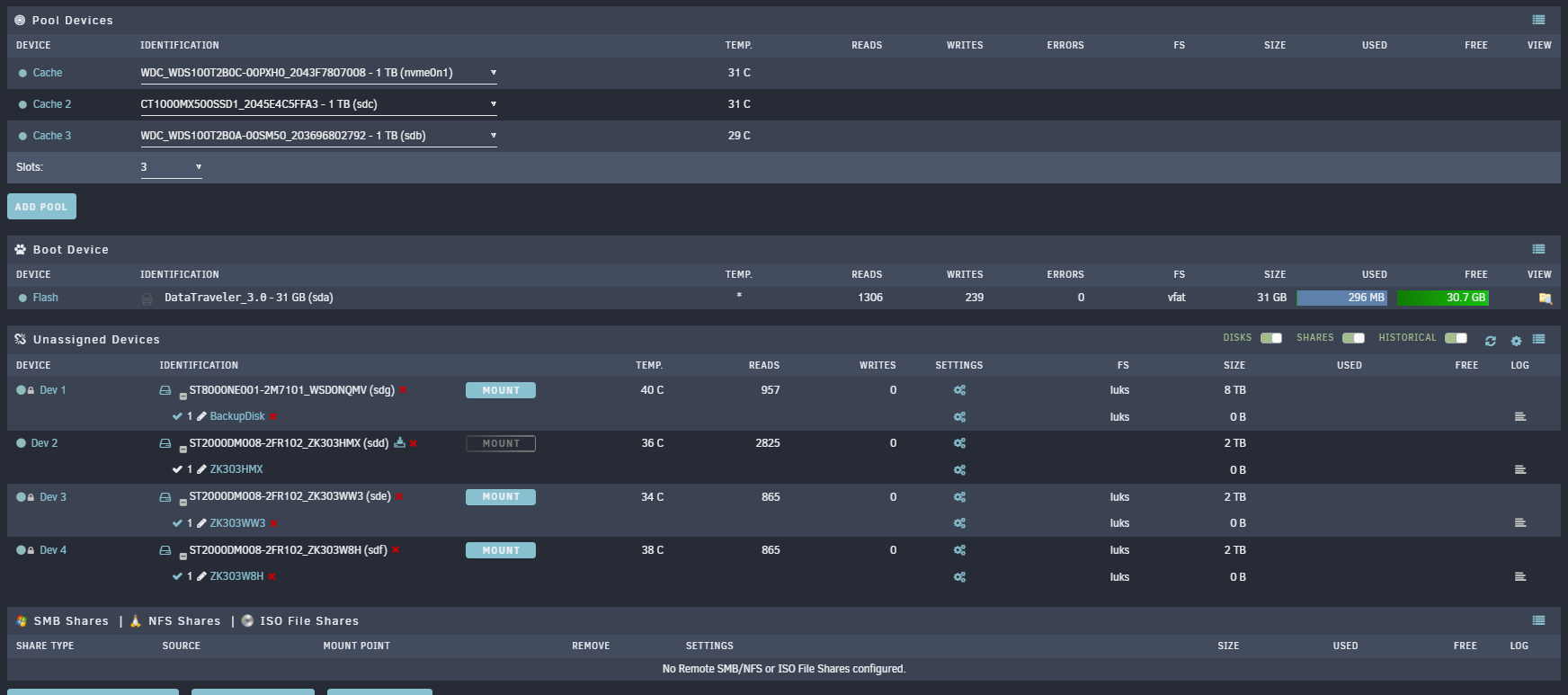

Get screen captures of the Main tab showing the disk listings for the Array, cache and Unassigned Devices.
Here are the requested screen captures ...

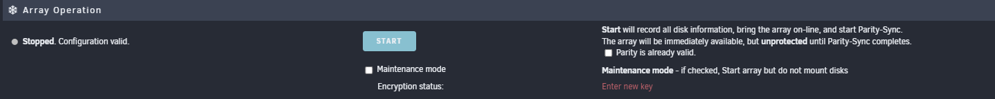

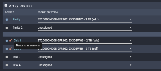

In the GUI I've now assigned the disks according to the DISK_ASSIGNMENTS.txt file in /boot/config - see screen capture below. (This file matches what I have in multiple backup copies, so I believe it's correct.) I believe the parity "should" be fine, but I am seeing a notice that a Parity Sync will be done (not parity check), implying that Unraid doesn't think that there is valid parity.
There is a check box to say parity is already valid. And one to enter maintenance mode. I'm inclined check both boxes and run a parity check on the array with the disks unmounted. Is that sane and reasonable?  BUT ...
BUT ... The array is already encrypted, AND the disk assignment list has icons on both Disk 1 and 2 that indicate the devices will be encrypted. There is also a prompt to enter a new encryption key, not an existing key, to start the array. Encrypting already encrypted disks sounds like a very bad idea to me. So now I'm not inclined to start the array. Any chance Unraid will discover that the disks are already encrypted and not re-encrypt them? Or can I tell it that somehow?

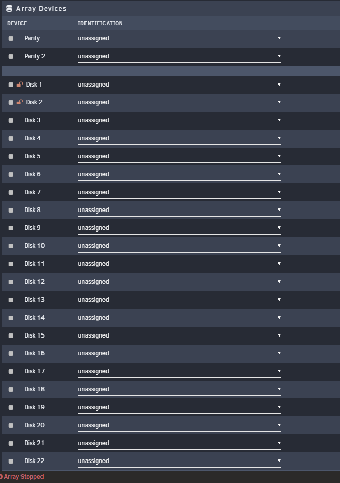

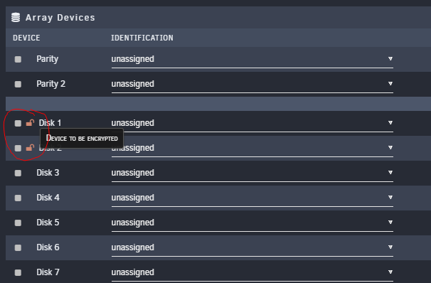

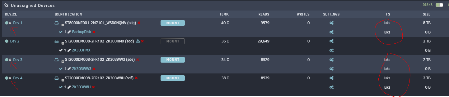

Interesting .... When I unassign the disks again, Unassigned Devices appears to figure out that they are encrypted.
But Unraid still thinks that those device slots are to be encrypted.
