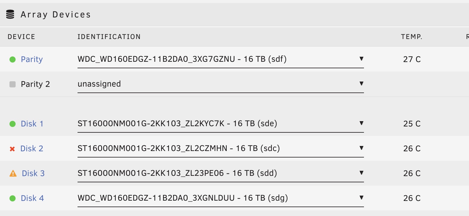

Two disks emulated, one is disabled
Recently, after upgrading a motherboard and cpu, same day one of the disks got disabled. I decided to do a full rebuild, and overnight it failed again, with now two disks being emulated. SMART check looks clean, so I assume it could have been the cables?
Any recommended steps to take next?

Single parity can only emulate one disk, you can force enable disk2, or even both, since they look healthy, do you know if anything was written to disk3 after it got disabled?
There's a chance there were some writing activity while the rebuilding was happening...
Went ahead and started array in maintenance mode, and finished data-rebuild, successfully.

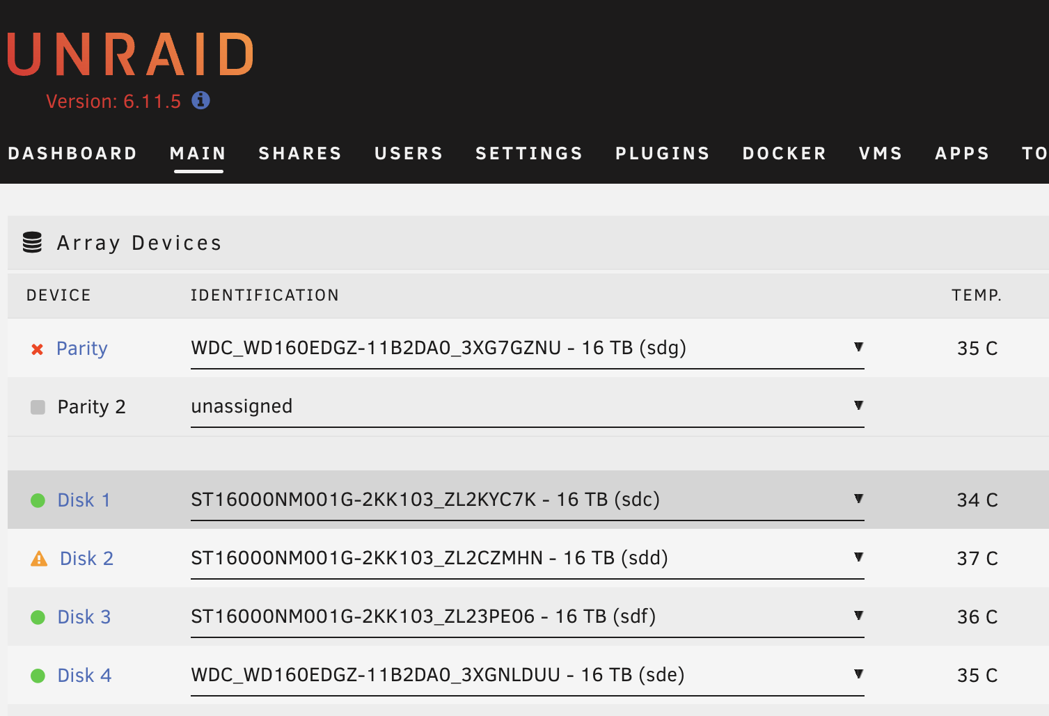

Screenshot suggests parity got disabled during the rebuild, since SMART looks OK but there's a recent UDMA CRC error it likely happened due to a bad SATA cable.

Currently, I have parity disabled, and upon rebooting shows crc error count 2. it also happens to be the one connected to the expansion card.
