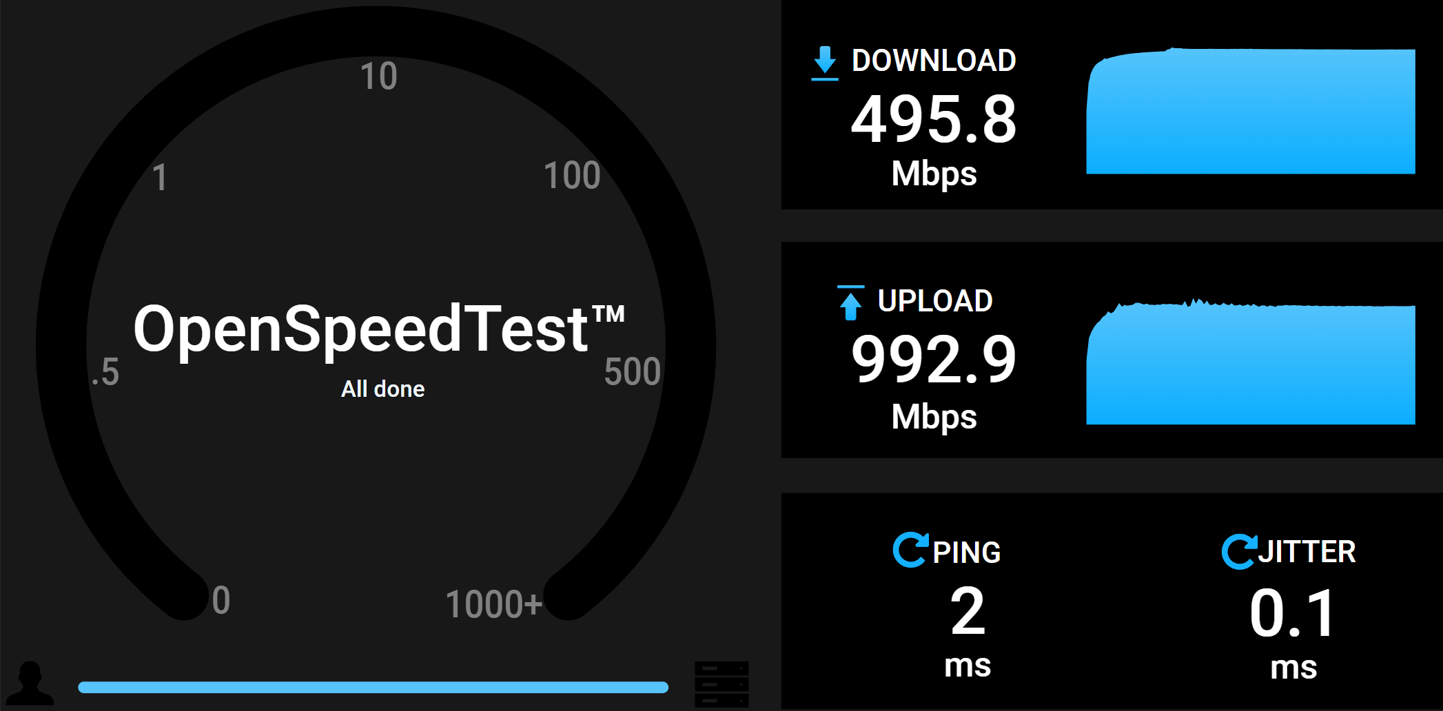

same if i am using the OpenSpeedTest Docker
I also tried downloading directly using the Dynamix File Manager. Same picture
so i think it is not a smb problem.

Since iperf show the same issue you should start with the LAN, that can be NIC (including NIC settings), cables, switch or client PC.
I have the same issues even with no antivirus. When using Manjaro everything is fine.
Hi thanks for the reply
setting of eth0 is: 1000 Mbps, full duplex, mtu 1500
I tried connecting my laptop directly to the server (using a different/new cable): no change
I tried booting a live-Linux on my PC to rule out windows/driver issues: no change
I tried a Linux VM directly on the server, connected to br0: here is everything ok.
So it seems that something is wrong with the NIC. Hardware oder setting.
I will try to boot the server with a live-Linux to test once I have time for that.
It cloud be a coincidence but it is suspicions that the download is limited to 500 MBit/s, so half of GBit. Is there maybe some QoS etc. in the system I am not aware of?
Edit: Tried booting a live-Linux on my server an did an iperf to my PC. Up- and Download are fine. So it must be a setting in unraid.
Edited by NilsonNeo4
live-Linux on Server
Look for the tips and tweaks plugin, there are some NIC settings there that can make a difference.
Thanks,
I disabled TCP offload. Now I have around 850 MBit/s. Still not full Gbit, but much better.
