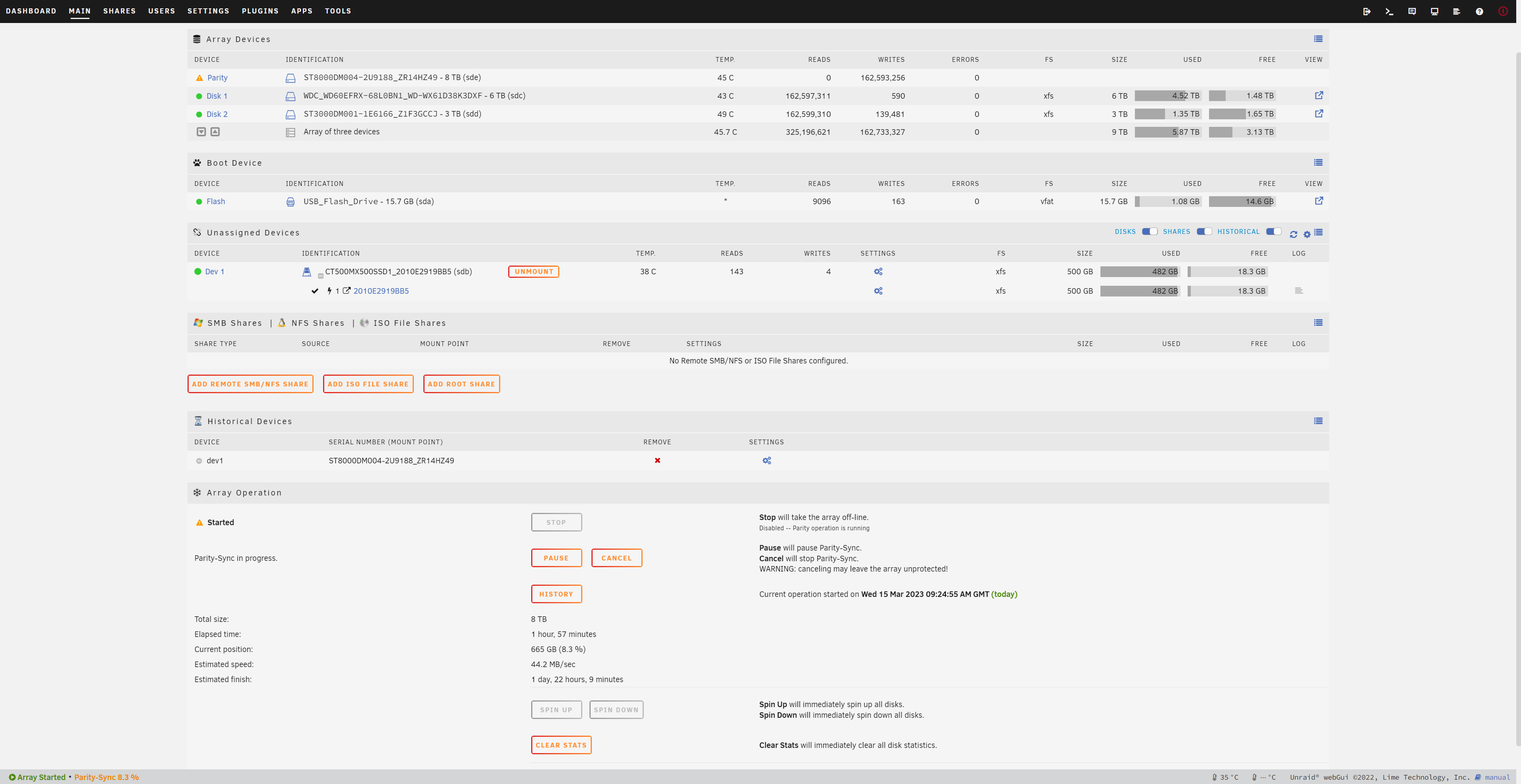

I bought recently a new drive with 8TB to use as parity (until now, my unraid server had no parity)
Well, I mounted it, and started the parity sync.
The speed of parity sync is, in my opinion, really bad, around 35MB/Sec, which will take days to finish.
I've read some posts and did some changes (disabled VM manager and docker, and assure that cache write was turned on).
Now, when I start the parity sync, it goes fine (around 170MB/Sec) until aprox. 8%.
At this moment, the speed drops to 35MB/Sec.
I've identified that at the beginning, the disks are rarely written.
When the speed drops, the disk 2 (sdd) is written almost every second.
You can find attached the diagnostics, and a print screen of my array.
Anyone can give me some hints on how to speed up things?
